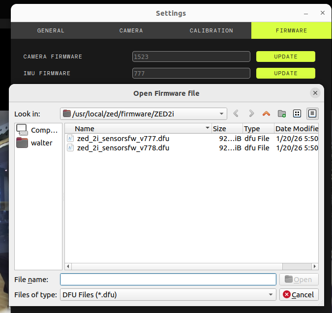

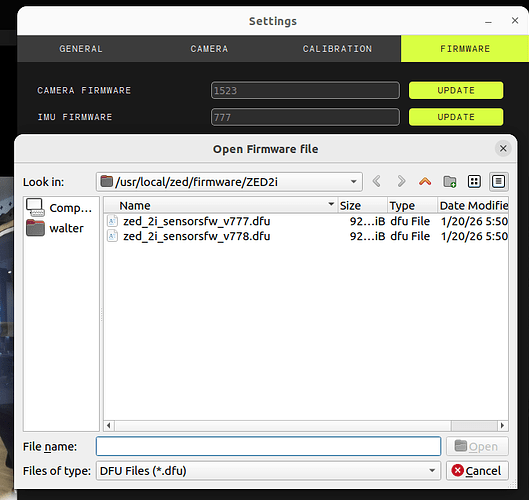

Hi @pachermann
This problem is normally caused by a bad initialization of the MCU that handles the data acquisition of the sensors.
Please open the camera with ZED Explorer and verify the MCU firmware version.
If it reports 777, please upgrade it to 778.
Please wait a few minutes for the process to complete, even if the ZED Explorer tool may look frozen.
