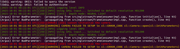

My setup is a Jetson Orin Nano and a ZED X Mini connected using the ZED Link Capture Card Mono. I also have a Display Port dummy connected and I am getting the following error when executing ZED_Depth_Viewer via ssh -X
Best regards
Hi @asolis_UJI
Unfortunately, all the ZED Tools cannot work with ssh -X.
If you need a GUI, I recommend you use NoMachine or RustDesk
Hello Myzhar,
Thanks for the reply. It is not only the ZED Tools that we are having problems with, it is also the zed-ros2-wrapper or any script we try to use to visualize the camera via ssh. We do not need a functional GUI, just want to visualize it.
This is the error we are getting with ros2-zed-wrapper. ROS2 is running in the Jetson. This is the command line we are using: ros2 launch zed_wrapper zed_camera.launch.py ‘camera_model:=zedxm’
Best regards
This could be another issue. We are off topic here. Please created a new thread and add the diagnostic report generated by the command sudo ZED_Diagnostic -c
