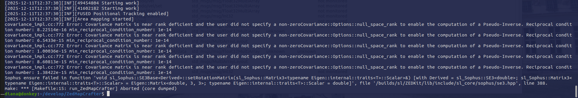

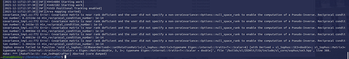

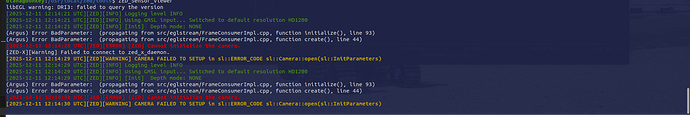

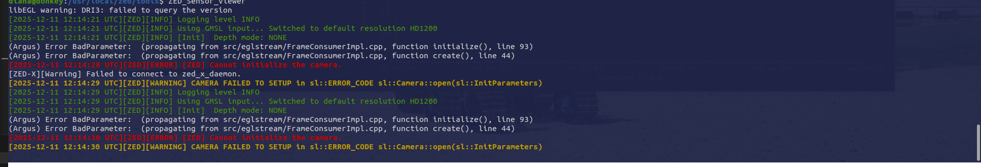

The ZED_Diagnostic -c command is now detecting the 2 zed. But there are still a lot of problems. All of the tools availble in the SDK fail to open the camera. I will attach a screen.
Our custom software can connect to the camera, but the reading in position estimation are very strange and wobbly. With the protype still we have a reading that goes from +10m to -10m, sometimes crashing with variance error (see screenshot).
