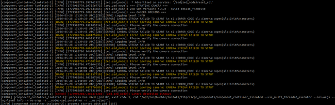

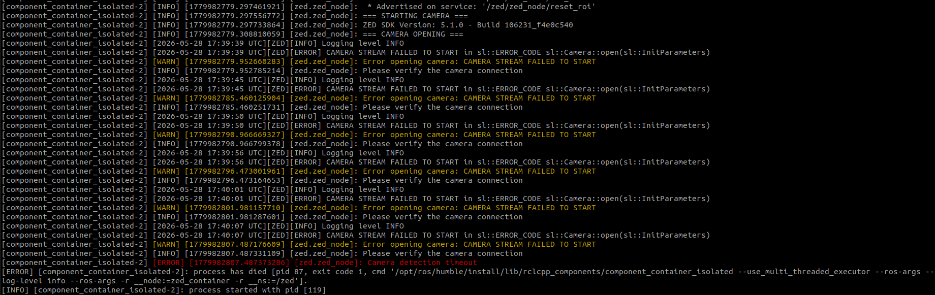

In our application, zed box mini and the cameras are mounted and running on a vehicle , hence it will be subjected to continuous powering off and on.Moreover the command you mentioned didn’t help detect the cameras without device reboot. Kindly find the error logs below.
I notioced that you are using the ZED SDK v5.1.0.
I recommend installing the latest version of the ZED SDK (v5.3) and ZED X Driver (v1.4.2) for improved connection stability and performance.
