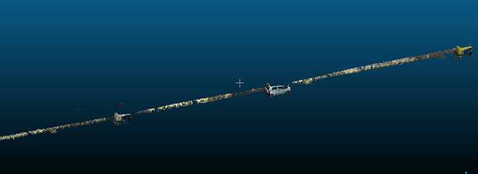

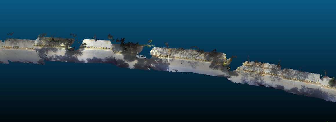

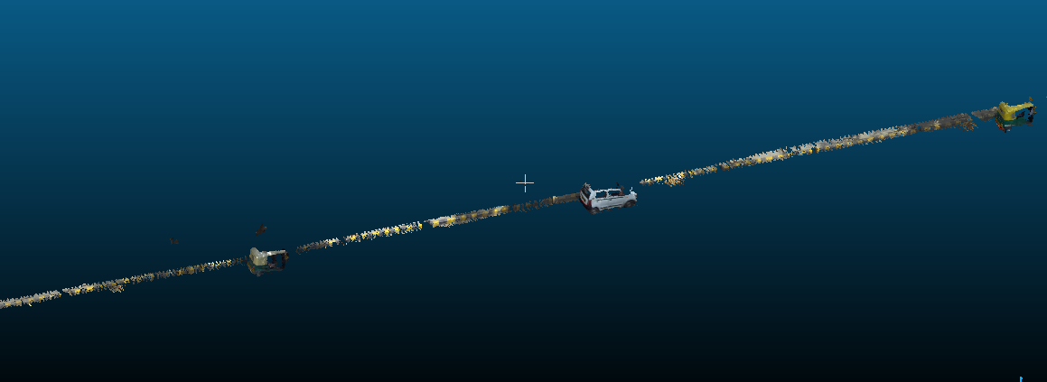

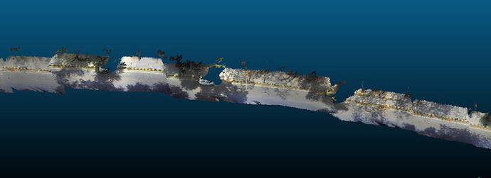

I’m working with the ZED SDK using the Python API to generate a fused point cloud and export it as a .ply file. However, I’ve noticed that the resulting point cloud is significantly less dense and lower quality compared to the one generated by the built-in ZEDfu tool, even using same svo2 file on similar parameters.
I’m using request_spatial_map_async() and retrieve_spatial_map_async() for mapping and point cloud extraction in the loop, as per the documentation.
Generated by ZED SDK Python’s API
Generated by ZEDfu
