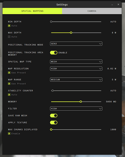

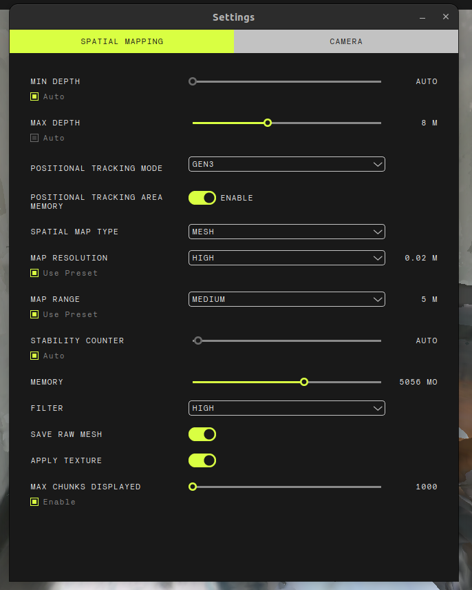

I’m using a ZED X Mini Stereo Camera with a ZED Box Orin NX (16GB) for mapping environments to export into Isaac Sim/Unity. Here’s a snapshot of my current ZEDfu (Neutral Plus Depth) settings:

Are you mapping live or did you also try the offline mode?
The offline mode should improve/fix the loop issue you have.
Thank you so much for this suggestion, Running offline definitely improved the map quality and localization.
