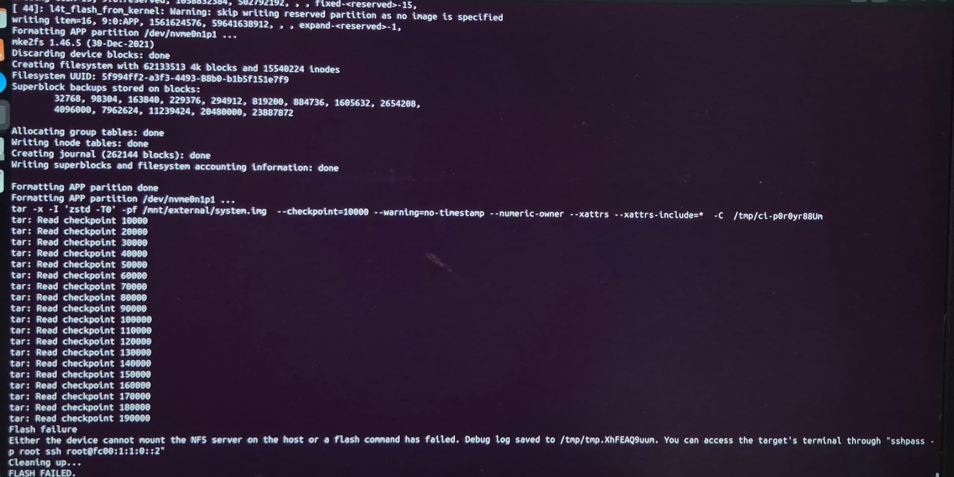

Im trying to flash a Zedbox after corruption. Followed the flashing document, and managed to start the flash. I ran i around 10 times already but it keeps failing.
The last few times, it failed at the “tar: read checkpoint 190000”
Adding an image of the terminal.
Thank you in advance!

i tried a few more times to flash, and managed to receive the error lines:
l4t_flash_from_kernel: Successfully flash the external device
l4t_flash_from_kernel: the device size indicated in the partition layout xml is smaller than the actual size. This utility will try to fix the GPT.
l4t_flash_from_kernel:  Error flashing qspi
Flash failure
Either the device cannot mount the NFS server on the host or flash command has failed. debug log saved to ….
Cleaning up…
FLASH FAILED
should i try a shorter cable then the one provided?
Thank you!
