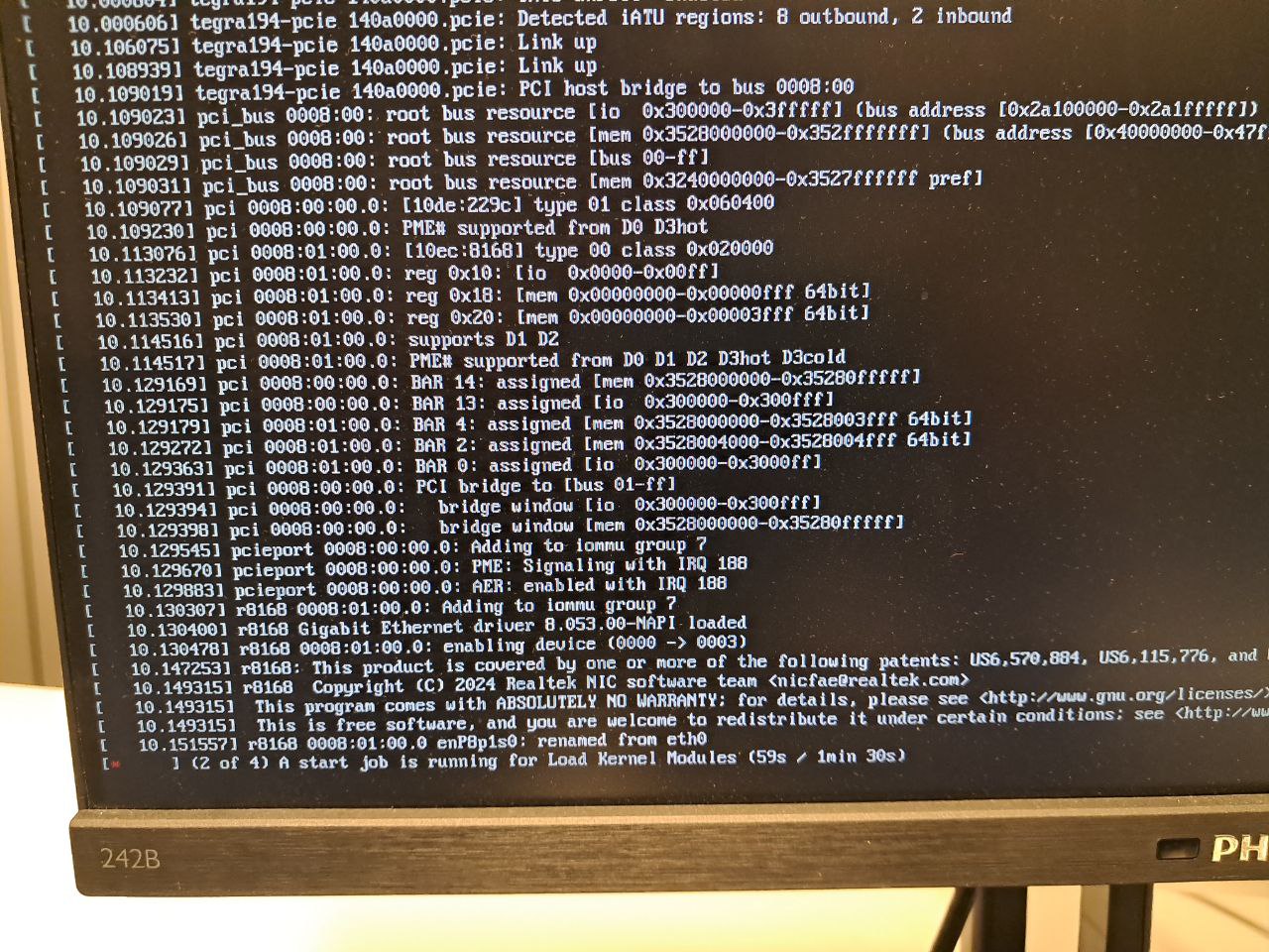

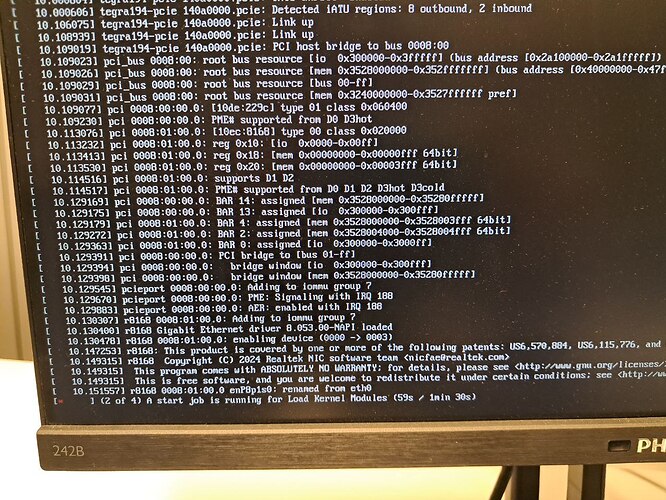

After trying uninstall and install snap for firefox opening problem on a ZEDBox Mini (Jetson Orin Nano) running Ubuntu 22.04 (JetPack-based), the device fails to boot properly. During startup, several “A start job is running” messages appear, and the system eventually drops into emergency mode.
During boot, the following messages appear:
A start job is running for Load Kernel Modules
A start job is running for dev/ttyTCU0
A start job is running for dev/ttyGS0
A start job is running for dev/disk/by-uuid/xxxx
