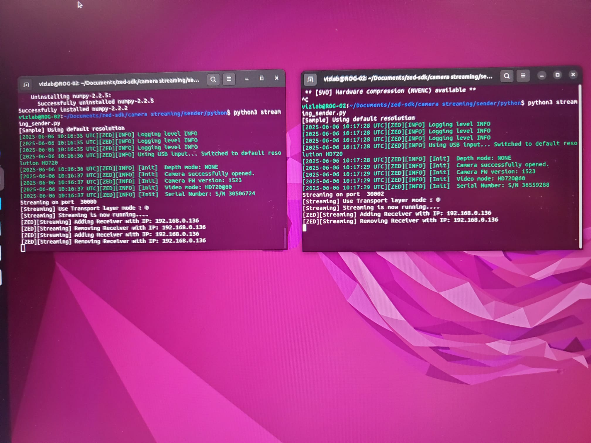

My steps:
Host 1: Open ZED_Explorer and connect to zed camera 0 > Create ZED strem using port 30000 > Open ZED_Explorer and connect to zed camera 1 > Create ZED stream using port 30002.

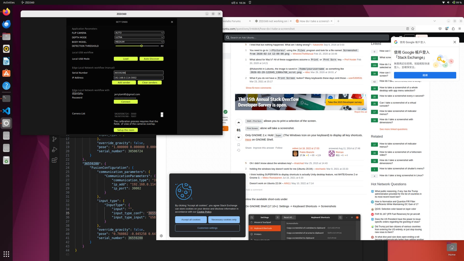

Host 2: Verify the stream using ZED_Explorer by entering corresponding ip and port number, both works > run ZED360 and enter ip, port and serial number respectively. Image below.
Click “Setup the room” and the following shows in the terminal
Unable to subscribe to 30506724 . CONNECTION TIMED OUT
Unable to subscribe to 36559288 . CONNECTION TIMED OUT

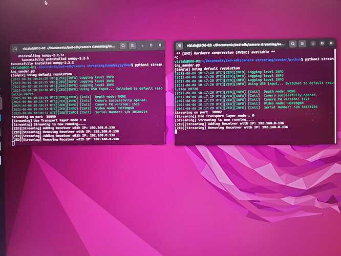

I have also tried using the camera streaming script instead of ZED_Explorer. Same behavior.
Image Capture from Host 1.
