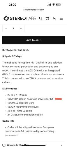

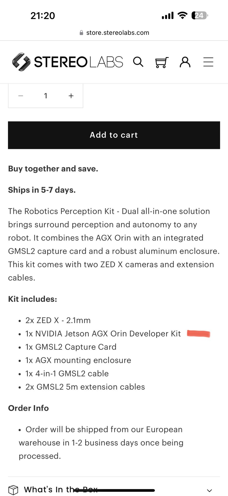

I am using this kit.

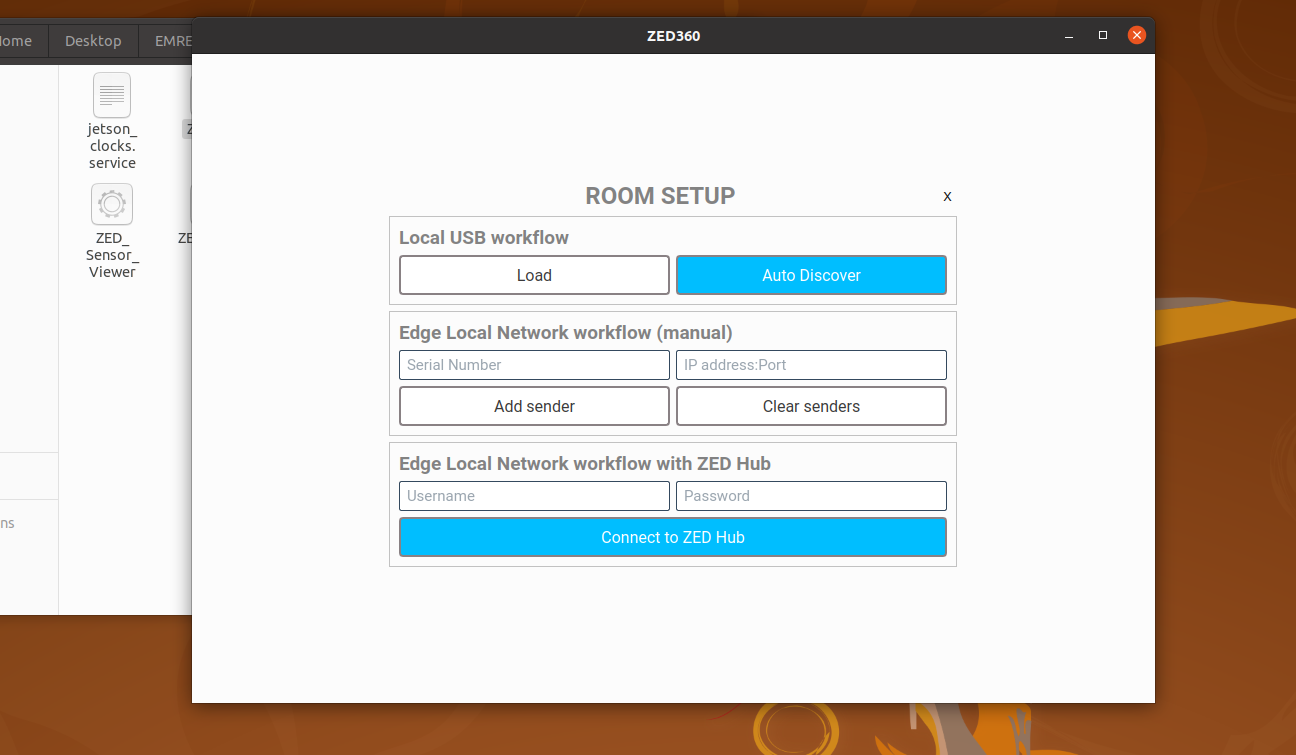

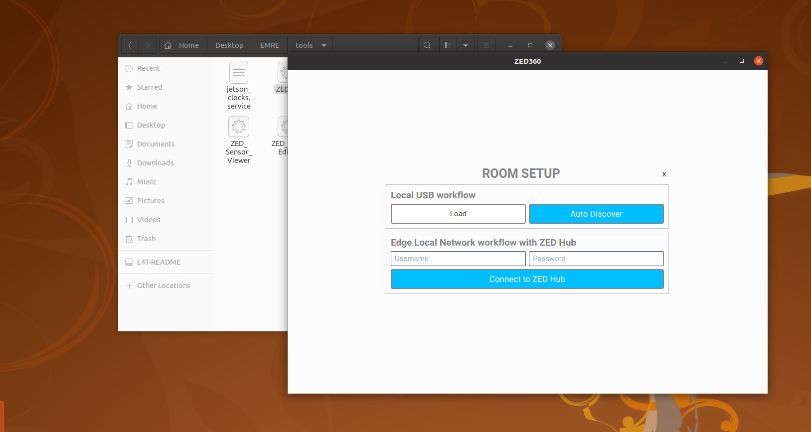

Seems like there is a little difference between 2 ways.
This is directly opened
And this opened with terminal.
As you can see room setup panel different. My zed sdk version is 4.0.8
Hi @emrekocdemir,
It appears that the ZED360 located in your path ~/Desktop/EMRE/tools/ is an older version of ZED360 prior to 4.0.8, which explains why it can crash.
Please only use the up-to-date version of our tools with respect to the installed SDK version, which are located in /usr/local/zed/tools/.
