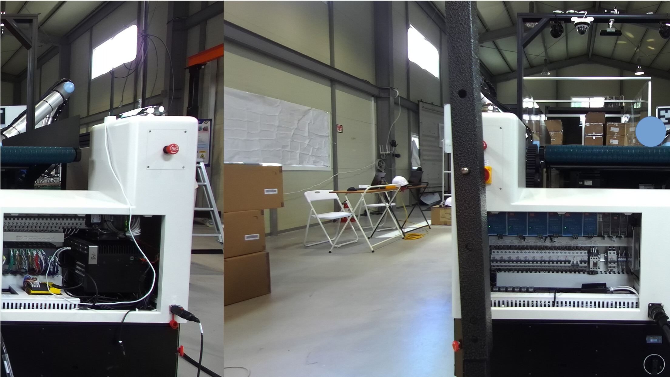

We are currently using two ZED2i cameras in a ROS1 + ZED SDK 4 environment and are experiencing an intermittent but critical issue.
:puzzle_piece: Issue Description

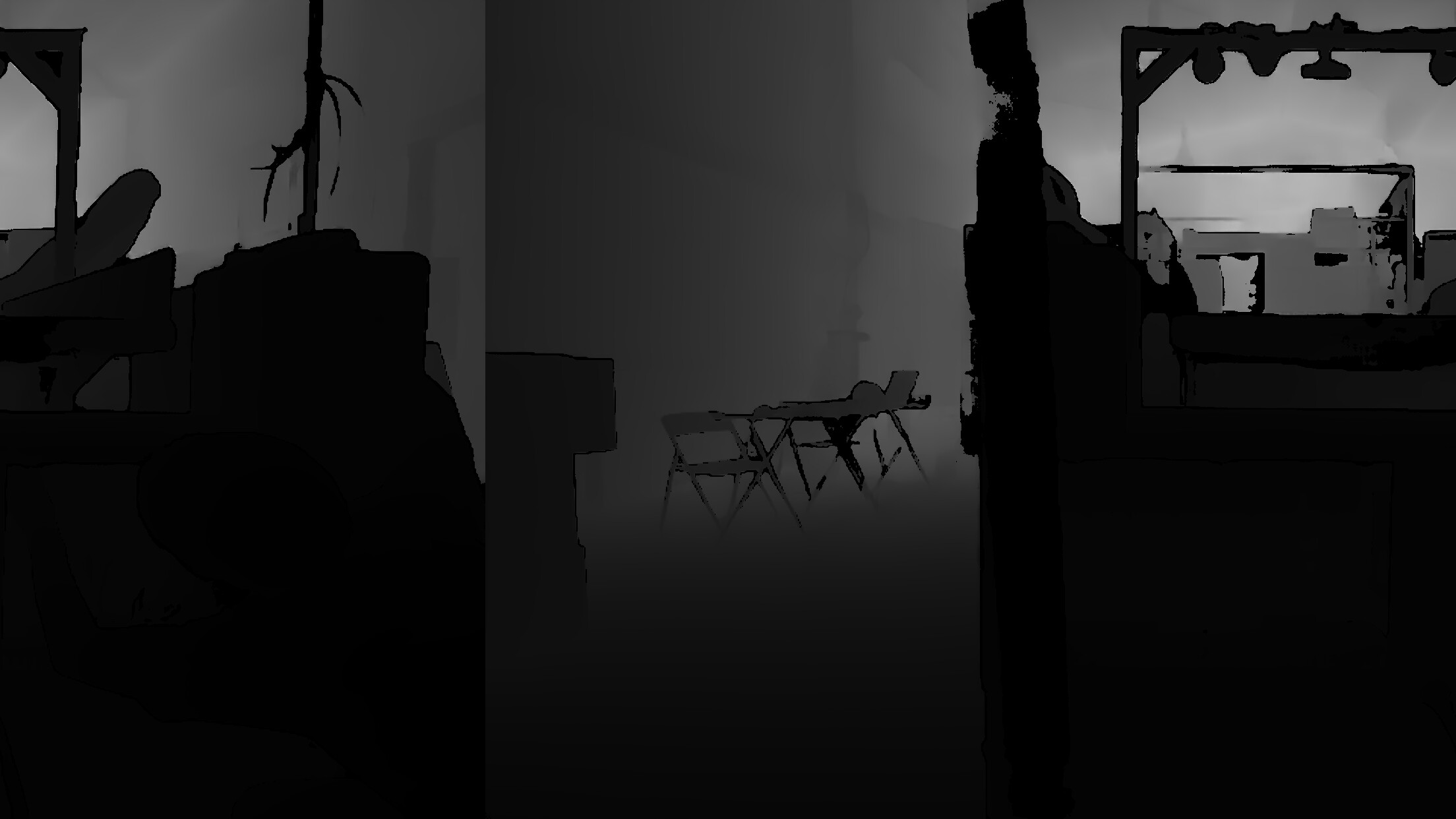

Occasionally, the image appears torn or inverted around the left 1/3 vertical region of the frame, as shown in the attached image.
This issue tends to occur more frequently during object detection tasks and is difficult to reproduce consistently. The affected region fluctuates within a ±15% range around the left 1/3 area, making it harder to isolate the root cause.
As a workaround, we tested reducing the resolution to HD720, which seems to reduce the frequency of the issue, but it still occurs occasionally. Therefore, the problem is likely not fully resolved by lowering resolution alone.

This issue has been discussed quite a few times on the forum, and there are plenty of conversations about it you can explore.
The frame tearing is normally caused by a bad USB 3 connection or a CPU overload.
In your case, I noticed that you are using two 5m long USB3 cables:
  • Are they connected to two separate USB 3 channels?
  • Are the cables active or passive?
  • Are you using USB 3 hubs?
