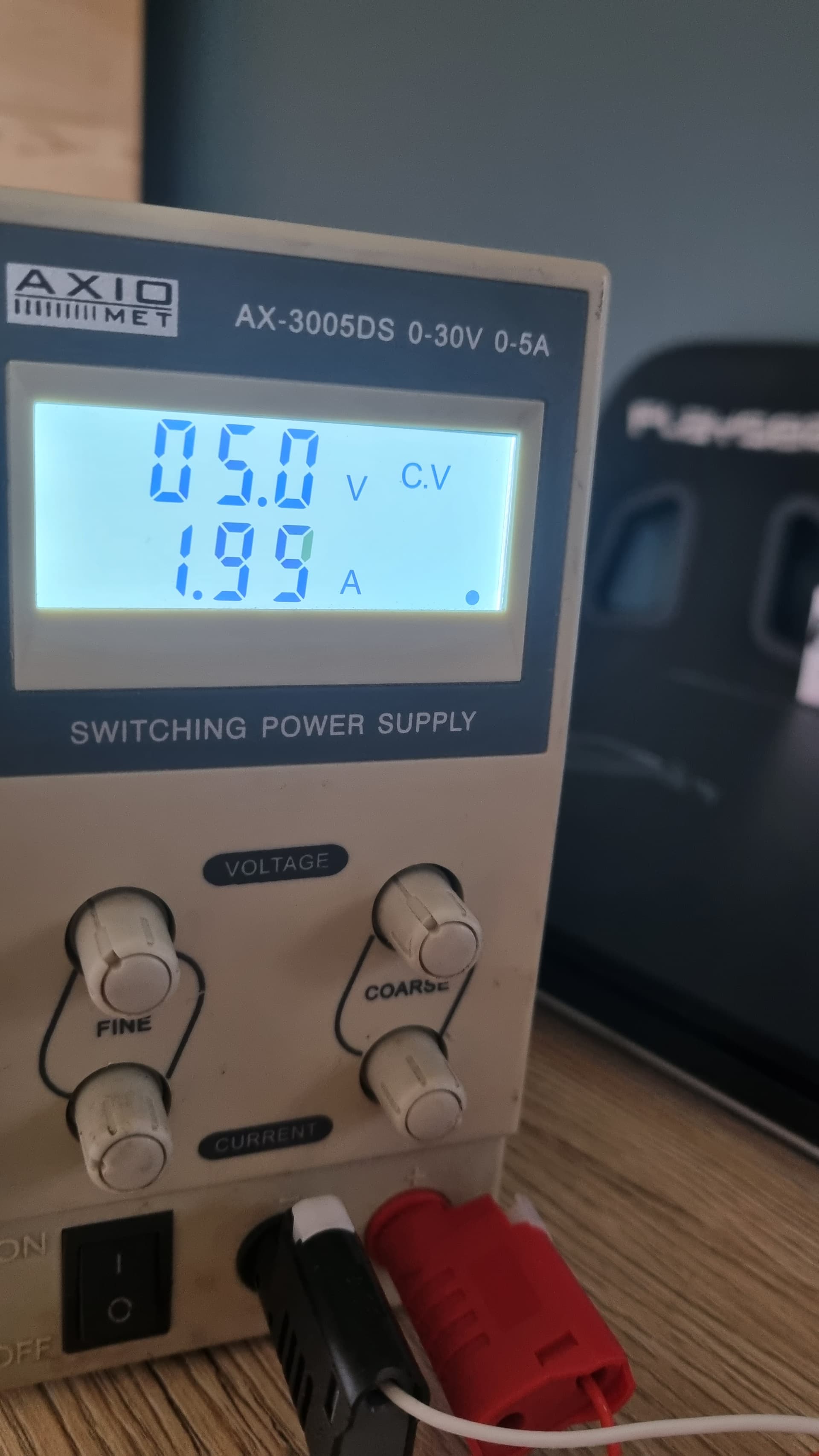

Coming back with good news, weird, but good.
I don’t know if last Jetpack release have change something on performance, supply or anything but :
I have always use a 5V 1.5A for my home test with ZED and jetson nano.
But after trying to check the usb stat with this command :
sudo lsusb -v
The result for USB port where ZED was connected return :
bcdUSB : 2.00
I have try with a regulated power supply like this one :
The result of lsusb was : bcdUSB : 3.00
And as you can see during stream with settings :
HD1080
30 fps
Bitrate 11000
H265
The jetson need at least 1.95A.
Now its all good.
