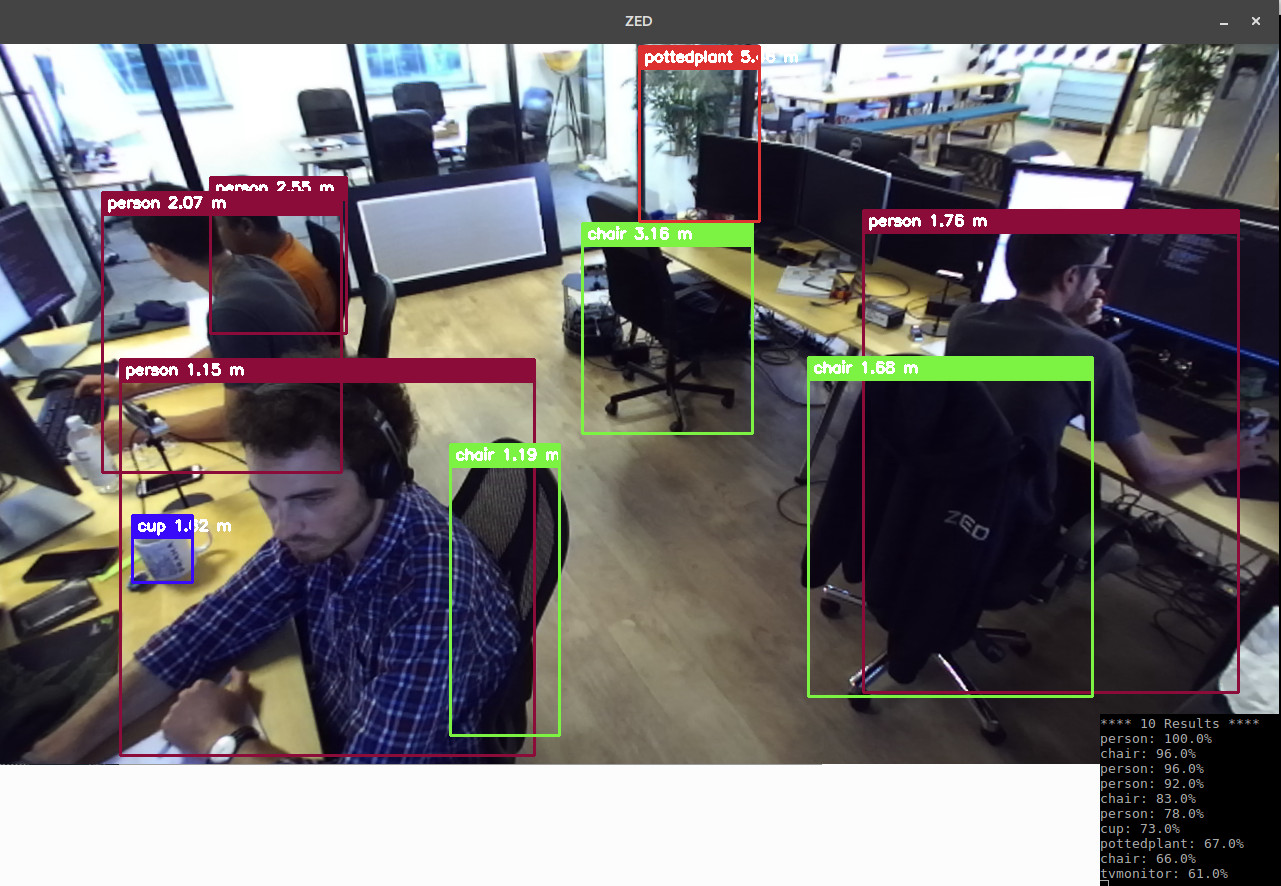

I want to be able to measure the distance of detected objects. The examples of object detection in the repo zed-examples are not having depth detection.
I took the code sample for Yolo object detection with depth measurement from the github link https://github.com/stereolabs/zed-yolo/tree/legacy

Thank you for your suggestion.
The example at https://github.com/stereolabs/zed-examples/tree/master/object%20detection/custom%20detector is working great. But it only is for object detection using Yolo.
I also want to implement distance detection for detected objects as shown in the example https://www.stereolabs.com/docs/yolo/images/zed-yolo-3D.jpg. How can I implement that? Any help would be appreciated.
Thank you
Hi again,
Our SDK provide something like that. You can proceed like stated in the documentation : https://www.stereolabs.com/docs/object-detection/using-object-detection/#accessing-object-information

Thank you for your support.
I have written the codes for both Python and C++ for Yolov4 object detection and distance measurement using the Zed SDK and Zed 2 camera. I have made use of the OpenCV DNN module for detecting objects using the Yolov4 weights.
My code works just like the example shown here https://www.stereolabs.com/docs/yolo/images/zed-yolo-3D.jpg
