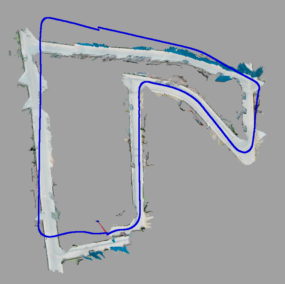

In the tests we have, the resulting GPS has continuous position jumps throughout the entire route. We have tried changing some settings but without achieving a smooth result.
It becomes more evident when we import the camera pose into Maya, since obvious jumps in height can be seen.
You can also see that despite the svo being recorded at 30fps in h265 lossy there are continuous frame drops throughout the journey. They can also be seen when playing the file in ZED Explorer
Just in case, we have also exported the image sequence from both cameras and processed it in Reality Capture, obtaining the same results with missing frames.
Returning to the topic of Spatial Mapping, we have not been able to get the geometry to match the calculated trajectory. You can see that at first it coincides, but as the recording progresses it becomes separated. The script we use is a mixture of several examples from the documentation.

Regarding the hardware we use, we only use the ZED Box Orin to record and repair the svo2 files, the rest of the process is carried out in Windows
I apologize for the delay in my response. It appears that your multiple issues are not related, so I will address each of them separately.
Indeed, small jumps in position can occur when the VIO position is being corrected by GNSS data. This situation is more likely to happen when either the VIO or GNSS system provides poor results. Several factors can contribute to these situations, including:
I have a question regarding your setup. Are you displaying the mesh computed by the sl::Camera object along with the position computed by the sl::Fusion object? If you are, please note that these two are not correlated. In order to project your mesh into a geo-referenced coordinate system, you can obtain the transformation between the ZED coordinate system and the Geo coordinate system using the get_geo_tracking_calibration function. Additionally, have you enabled GNSS rolling calibration in your tests?
I hope this answers your questions.

Spatial Mapping
Possibly I’m getting it wrong.
What I don’t really understand how to do is that when executing:
mapping_state = zed.get_spatial_mapping_state()
How to tell “zed.get_spatial_mapping_state()” to use the camera pose obtained from the fusion.Because from what I understand from the screenshot is that it is using the pose calculated in VIO
It doesn’t seem like it’s a coordinate reference system problem.
I’ve been looking at SpatialMappingParameters and several other functions that seemed related, but I haven’t been able to find how to define which camera pose it uses.
Something similar to how when I take the camera values to save them in a .csv
fused_position = sl.Pose()
# Get rotation and translation and displays it
rotation = fused_position.get_rotation_vector()
translation = fused_position.get_translation()
rotation_euler = fused_position.get_euler_angles()
Yes, we know, but since we did not notice any notable difference in performance between version 4.1, 4.1.1 and 4.1.2 we only did the tests comparing 4.0.8 and 4.1.2
Yes indeed the 4.1.2 is the latest release, it solve a lot of GNSS and VIO issues, you should use this version.
Unfortunately you are right the spacial mapping is currently using the pose computed by sl::Camera. There currently no way to use this with fusion computed pose. What I suggested is to project your spatial map into fusion geo-reference thanks to computed calibration but indeed this do not feet your problems since you need accurate position.
Spatial mapping thanks to fusion position is on our development road-map. However, I am unable to provide a specific release version for this feature at the moment.
