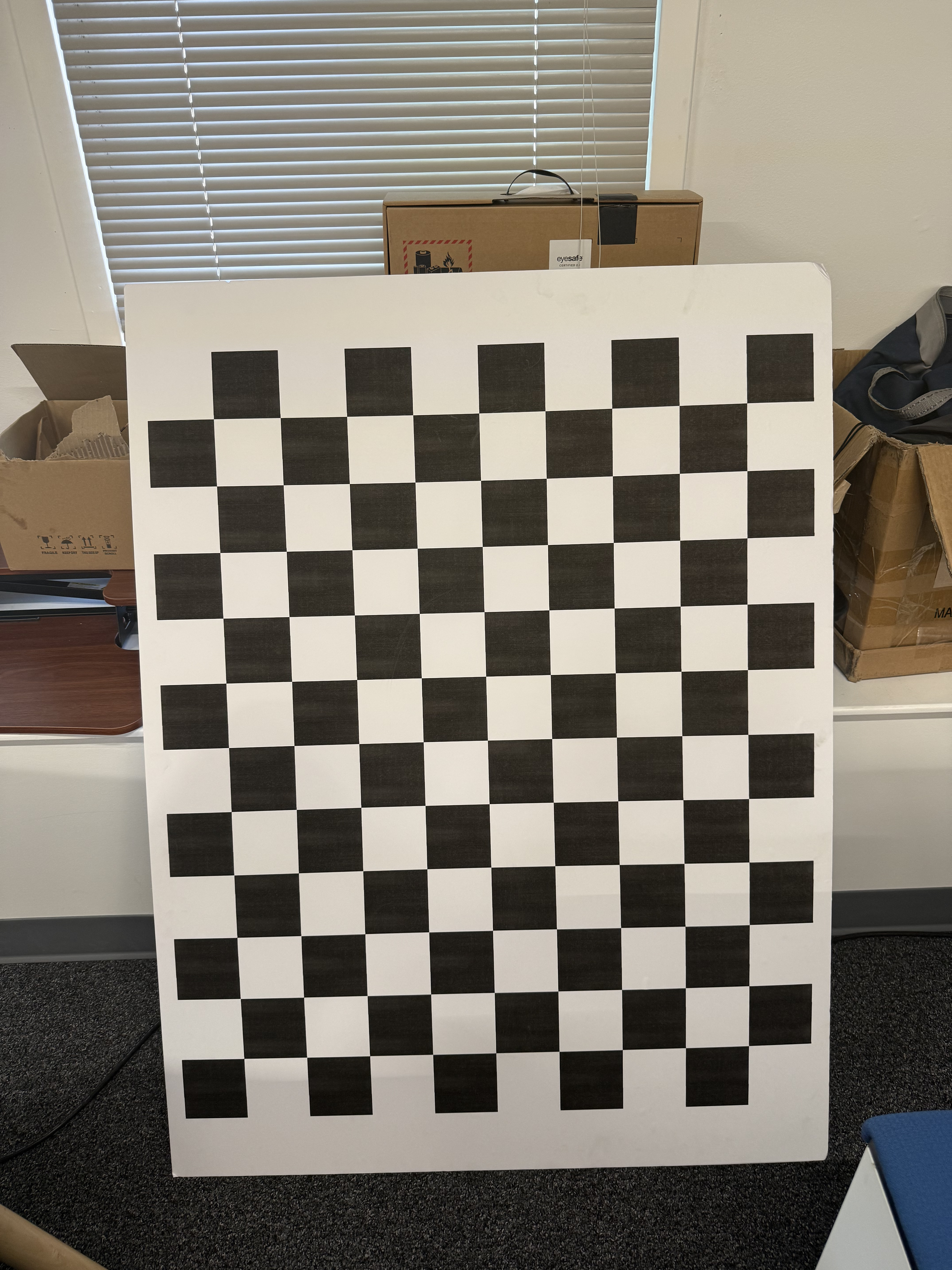

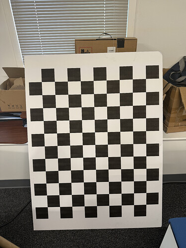

Have you configured the example to match the features of your calibration board?
What you describe is normally caused by the code not detecting the board.
Please send a picture of the board that you are using and the settings.
Sure!
I can see in the real time viewer that >80% of the points are being found (looks close to 100%). My settings are:
int target_w = 11; // number of horizontal inner edges
int target_h = 9; // number of vertical inner edges
float square_size = 86.0; // mm
The slowness is mostly when I click ‘s’, it takes 3 minutes (timed) for those images to save (as showed in the terminal output). About halfway through the coverage process, I keep getting prompts that the “Application is not Responding”, but if I wait long enough, that does go away. So far, if I wait long enough, it ends up being ok.
Calibration parameters look correct.
