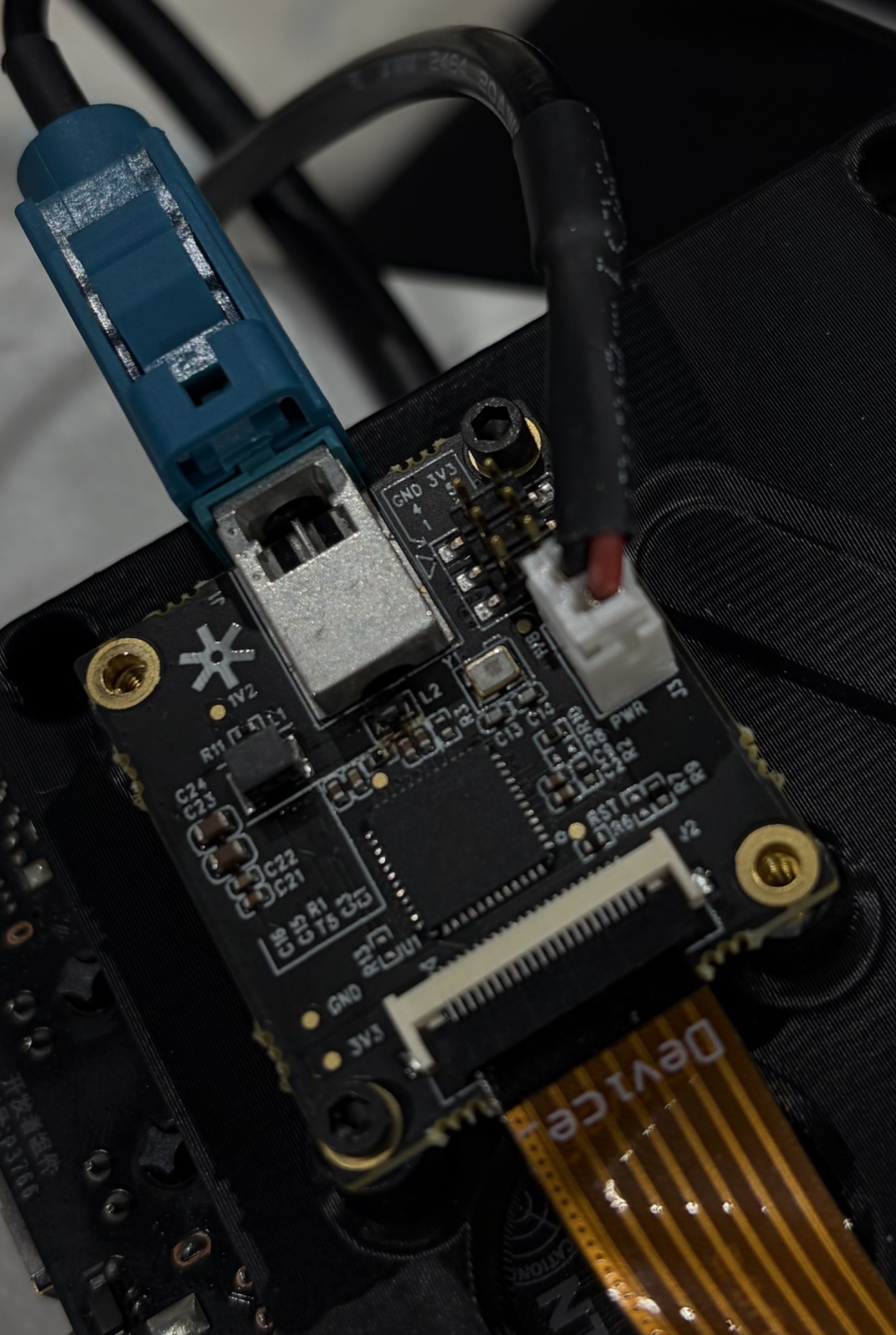

Upon inspecting the deseralizer board itself, i noticed some browning around the L2 component.
There are no indicator lights on the mono board or camera for me to verify if the Fakra is delivering 12v power. I’ve used several other cheap GMSL solutions, but I had issues with those breaking so I hoped something more expensive would be more robust. Does anyone have an idea of what could have caused the failure? Or the best way to verify if it’s a hardware or software failure. Also if this kind of problem has been discovered before, and how to fix/avoid causing it in the future.

Hi @Noah07
Please email support@stereolabs.com to request a replacement for your capture card.
