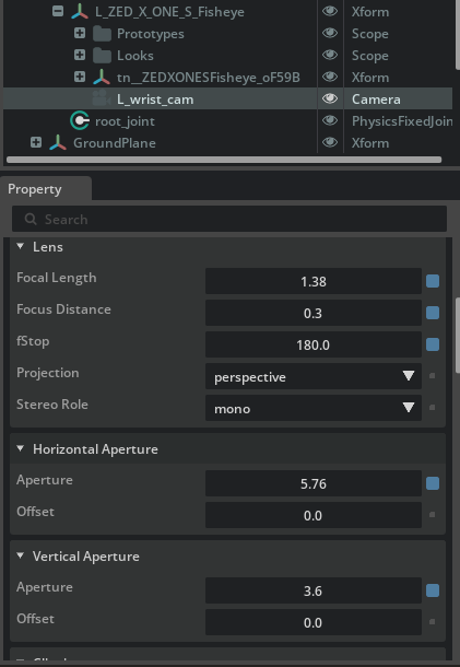

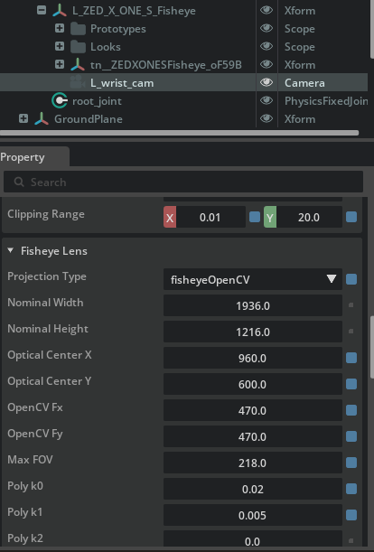

However, for the ZED X One S, since there are no ZED X One S model in Isaac Sim yet, I am attempting to use simply import the 3D model of ZED X One S, add Camera in Isaac Sim, and connect to ZED One Camera while simply setting it as ZED X One GS model.
Here are the questions/issues that I am facing:
  1. As I do not have a physical ZED X One S fisheye model yet, I am unable to set parameters for the camera module in the isaac sim. Would it be possible to retrieve arbitrary values that I can use?

Regarding the ZED X ONE S, when will it be available in the Isaac Sim?
Until then, is there any a camera parameter values in Isaac Sim that you recommend for the simulation of the ZED X ONE S fisheye lens model?
Currently, I am thinking of using the provided arbitrary values and make changes when the physical camera arrives and I finish the calibration.
You can use the ZED X One GS for now. The only diff is the size of the camera, the rest is the same.
