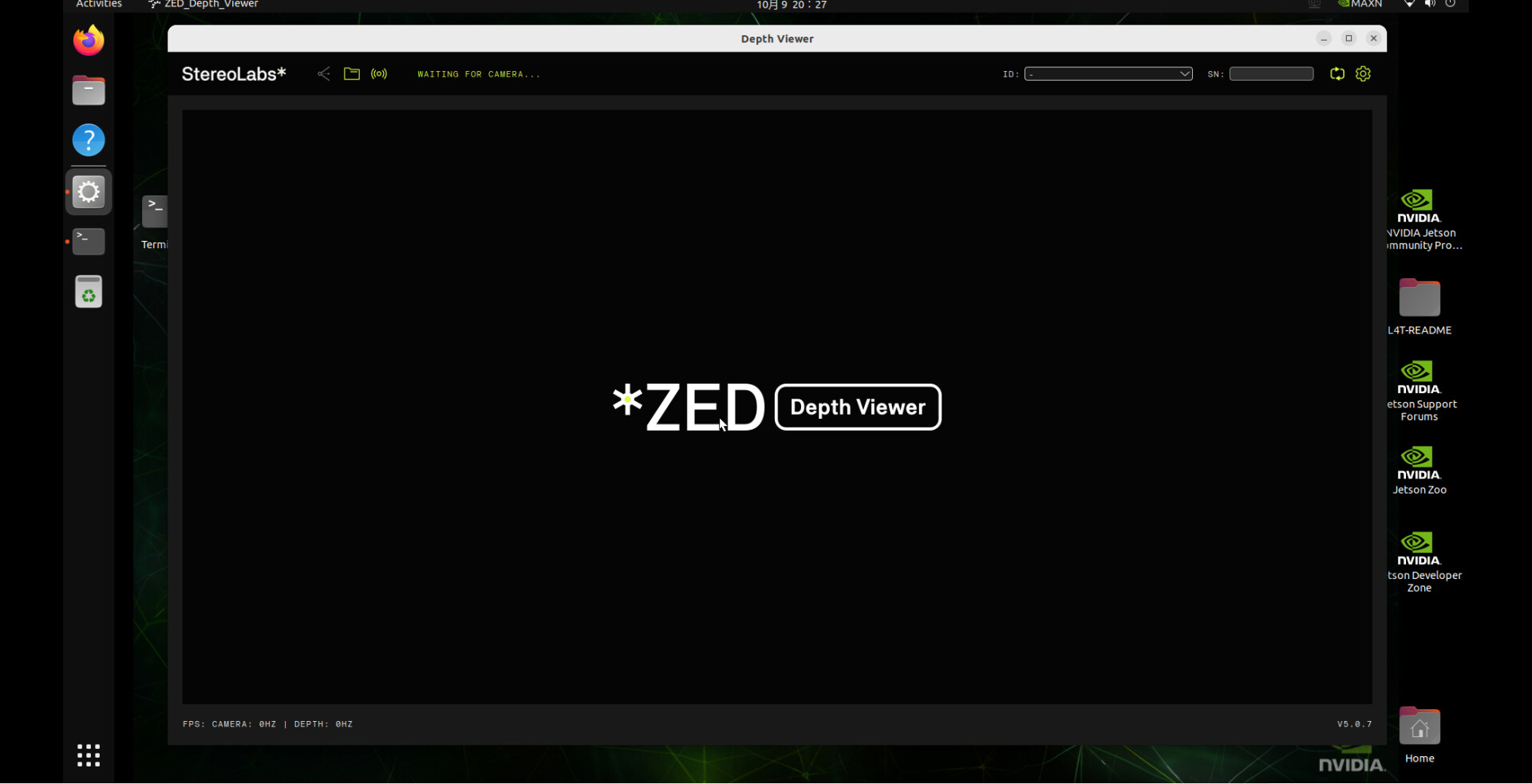

As shown in the image, the ZED Depth Viewer is stuck in a “waiting for camera” state and won’t open. Below is the full report from my ZED Diagnostic .
ZED SDK Version (Diag): 5.0.7
ZED SDK Version (RT): 5.0.7
