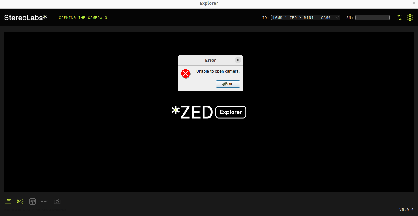

I think that ZED Explorer doesn’t let us configure framerate or resolution from the ZED Explorer before opening the camera. The ZED X One 4K fails before any stream or setting can be applied, so we can’t even reach the point of adjusting settings for that camera when the Mini is also connected.
First, it toggles quickly between “OPENING THE CAMERA 0” and “WAITING FOR CAMERA 0”. Then, it delivers the error message of the image we have attached. Also, you can see in the image that it is detecting the ZED X One as “ZED-X MINI”.
When we change from CAM0 to CAM1 in the dropdown ID menu, we can see without any issues the ZED X Mini stream.

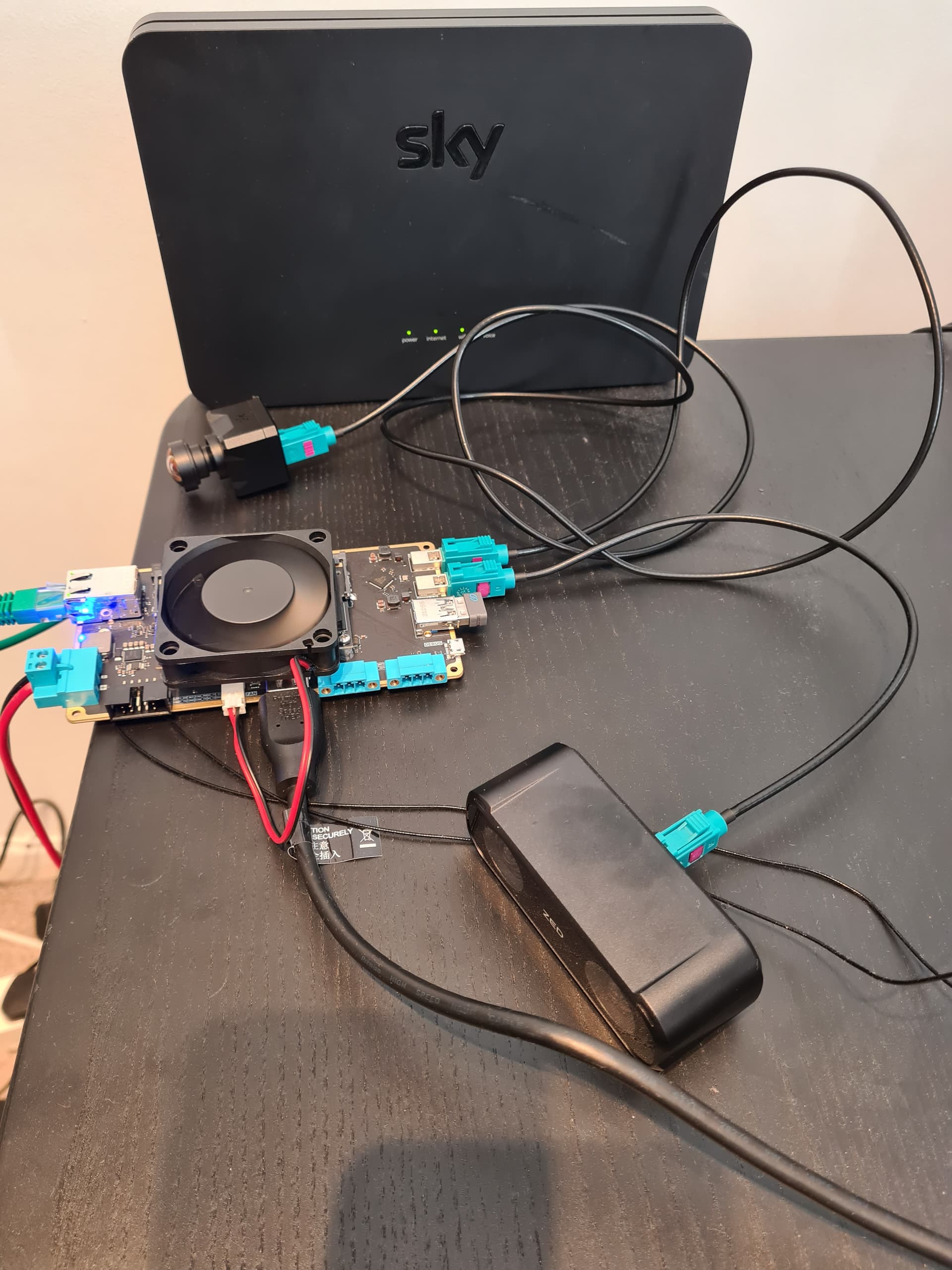

Can you please send a picture of your setup showing all the connections?
Sure, here is a picture of the setup showing the connections.
This is weird because it seems that the two cameras are both detected as ZED X Mini models.
Have you disconnected them and reconnected while the host was powered and you did not launch the sudo service zed_x_daemon restart command?
