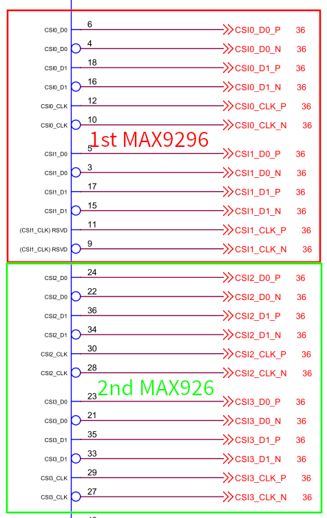

  1. Pin-out of Jetson Orin Nano CSI pin to MAX9296

Hi @Neko-Chang-Taiwan
I suppose you can access the ZED X Driver GitHub repository.
In this case, I recommend you submit an issue to it to get in direct contact with our embedded engineers.
Otherwise, please write an email to support@stereolabs.com
