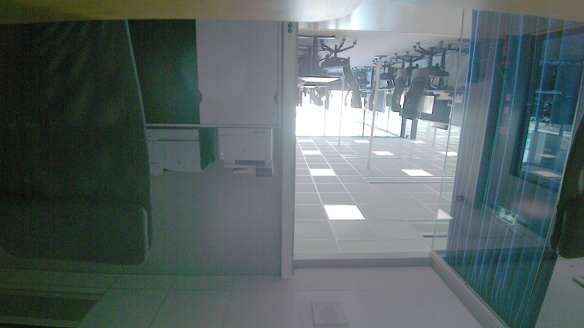

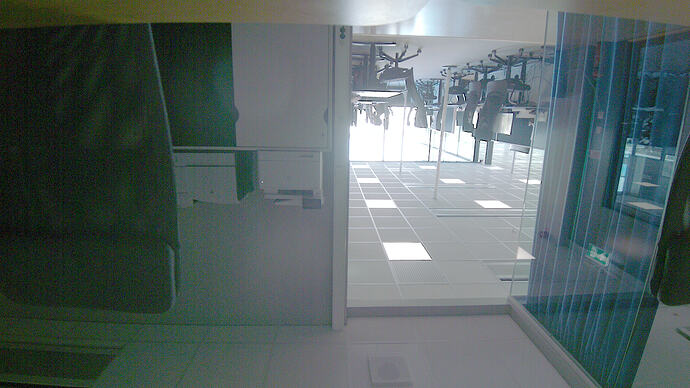

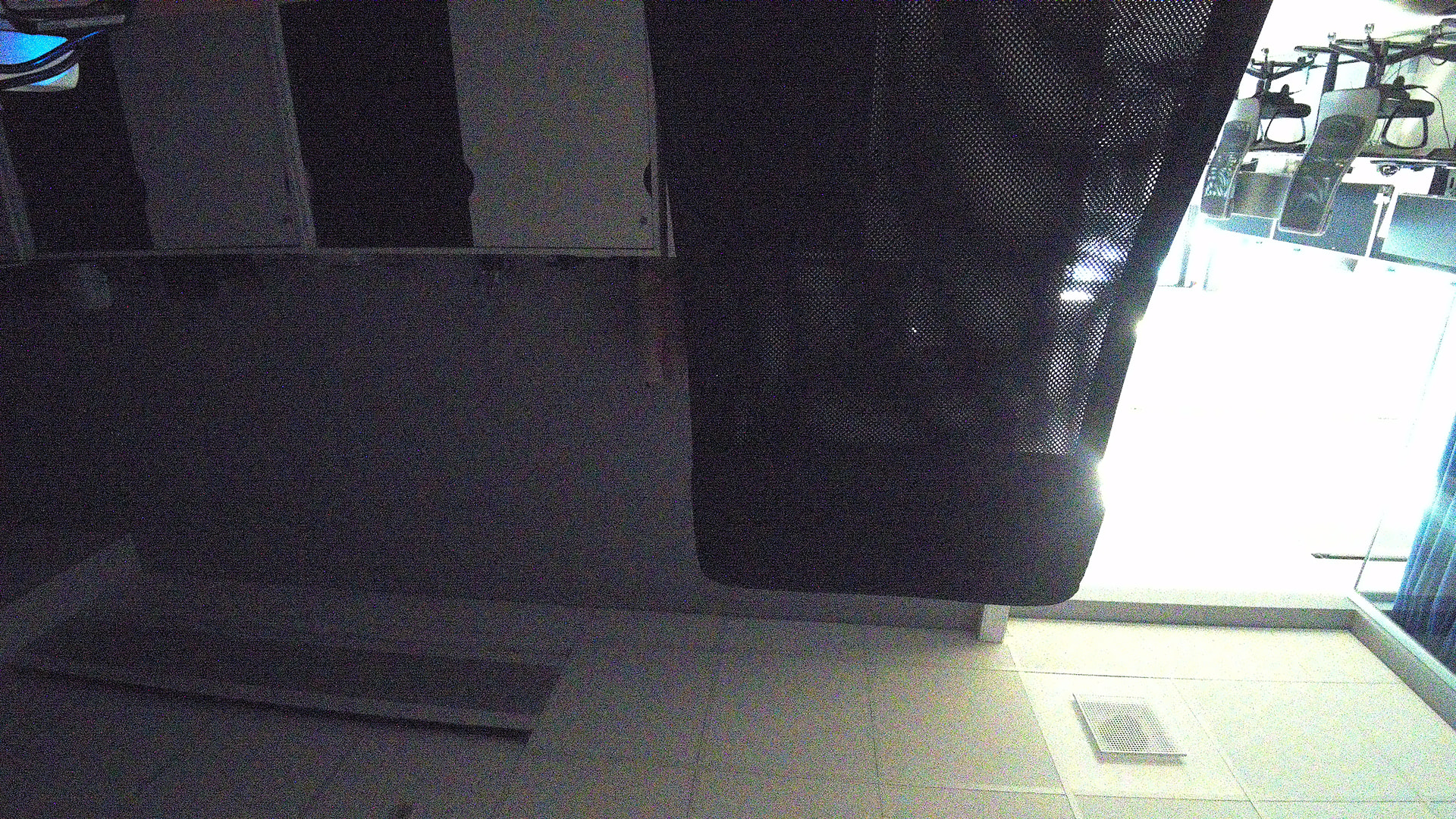

2- We see that the 1200p and QHD+ configurations support HDR, however, when activated we see bad image quality, as you can see in these images (grabbed from ZED_Explorer)
QHD+ with HDR
1200p with HDR
Do you have any thoughts on what parameters to tune, or other approaches to use to improve the image quality in these cases?

Thanks for your reply. We didn’t try the newer versions at first since we are currently using ZED X driver v1.4.1, which according the release documentation “Reduced high noise levels when using HDR mode on the ZED X One 4K“ and we didn’t see any fixes related to HDR in v1.4.2 release documentation.

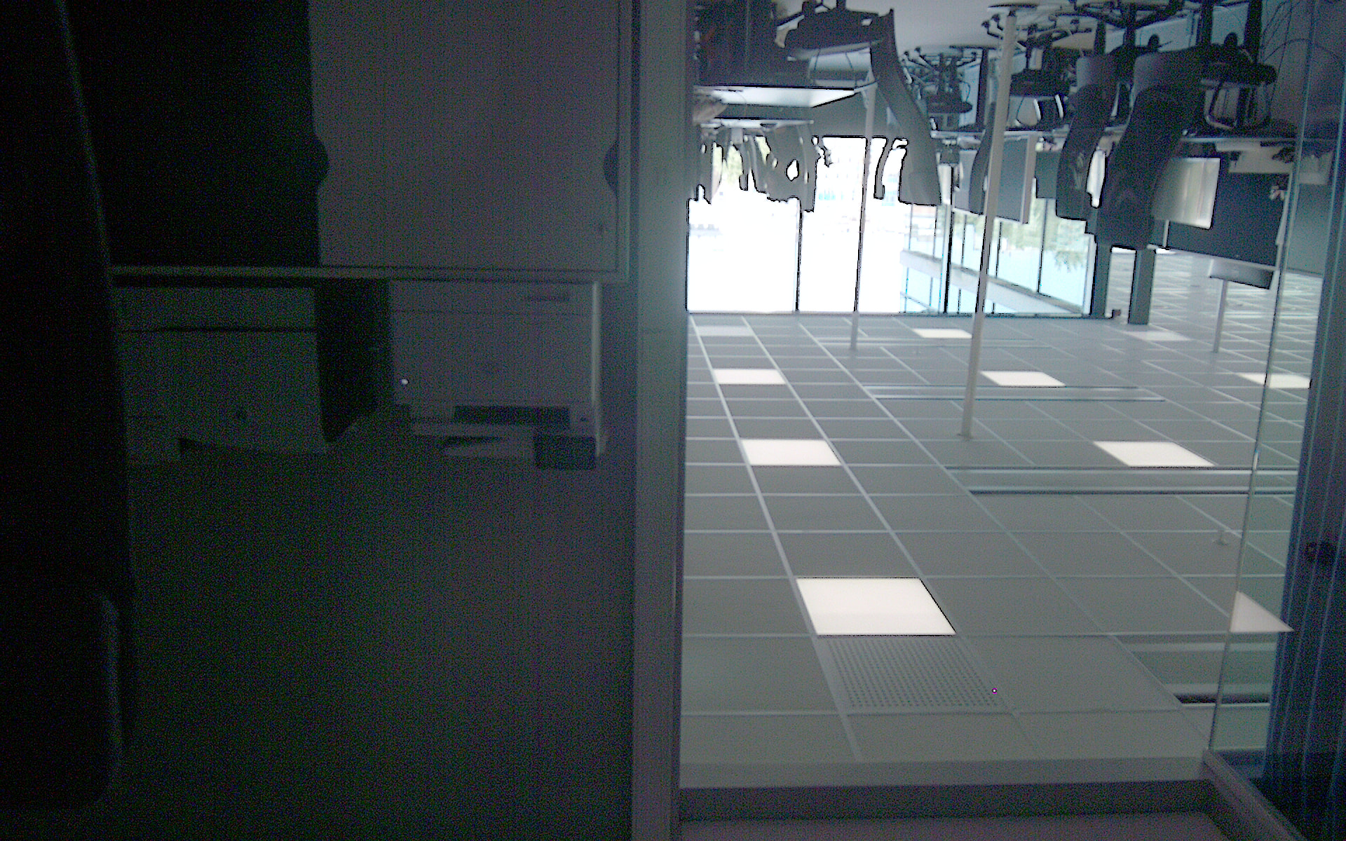

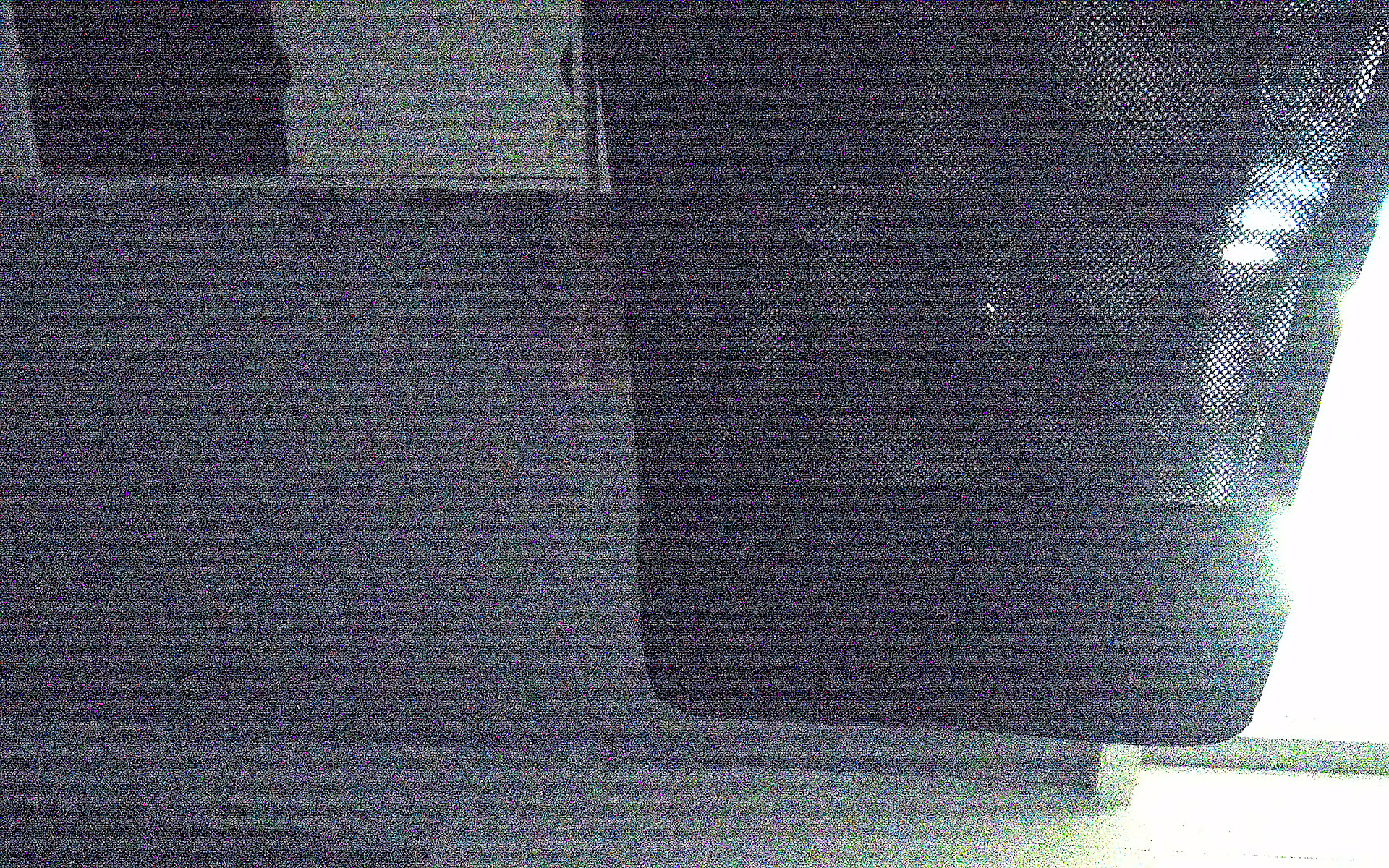

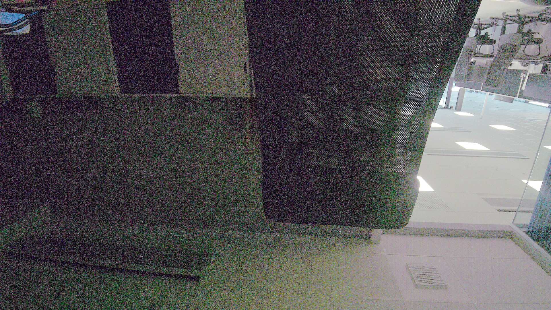

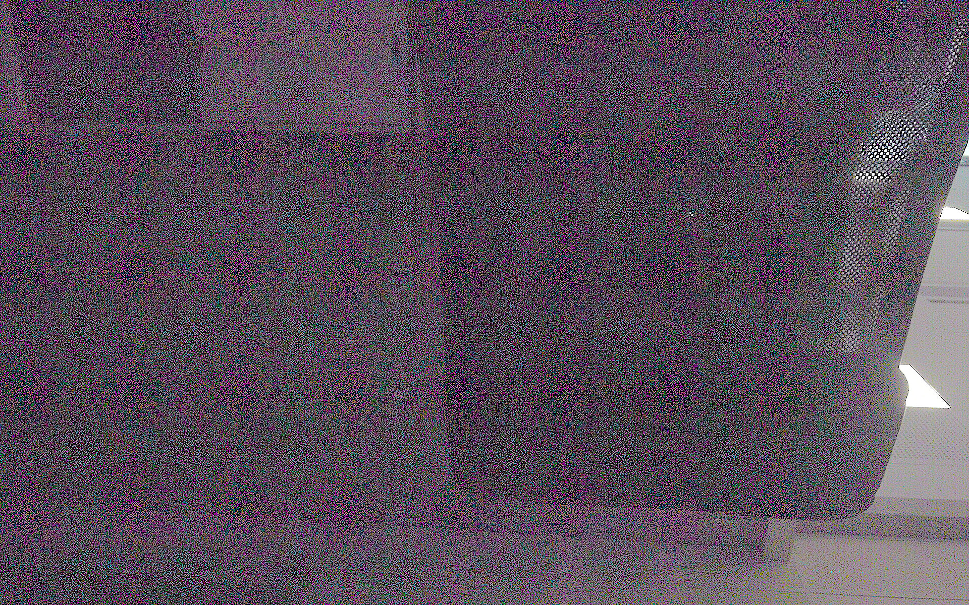

After updating to the suggested versions we see the same problem (the image quality is even worse, since now it’s even darker in the room where the cameras sit) - let me know if you prefer to reproduce it in other conditions
HD1200 without HDR
HD1200 with HR
QHD+ without HDR
QHD+ with HDR
Also, here is the accompanying ZED_Diagnotic report after the update
ZED_Diagnostic_Results.json (18.6 KB)
Hi @enunes
Thank you for reporting this problem.
I’ve just forwarded all the details to the hardware team.
It’s probably an ISP tuning issue that will be fixed with one of the next release of the ZED X Driver and ZED SDK.
