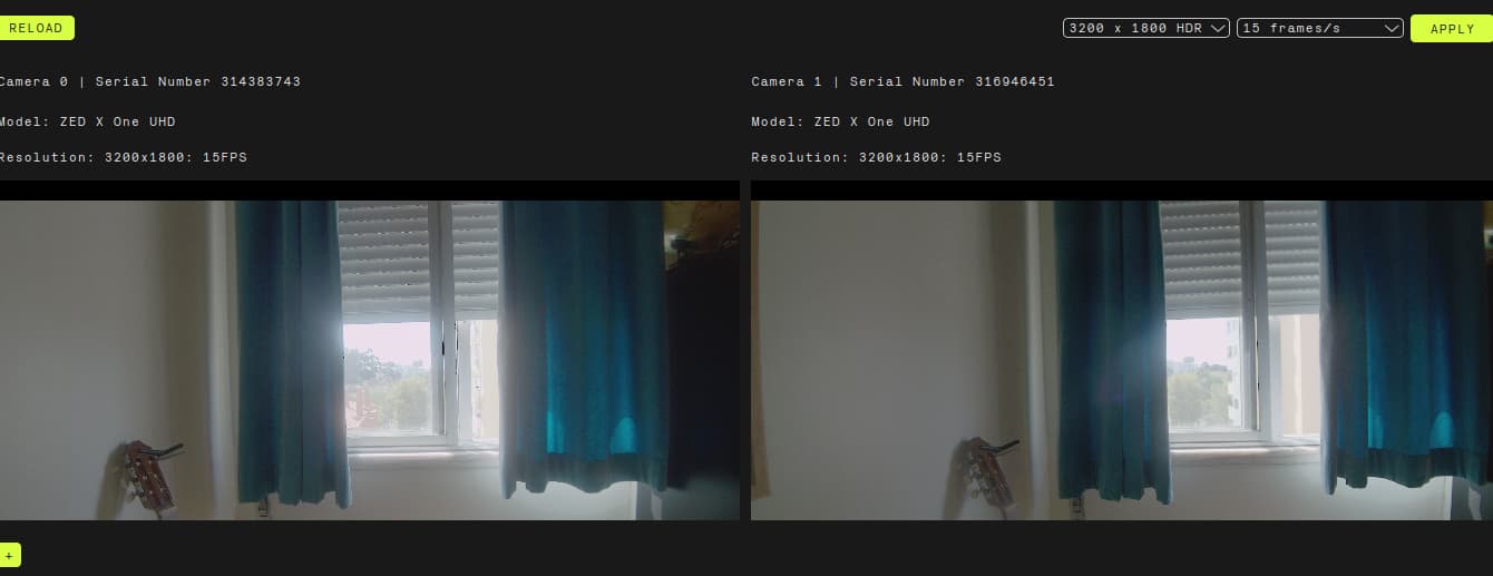

When I set up the stereo pair in the ZED_MEDIA_SERVER at max resolution with HDR, the preview actually looks good:

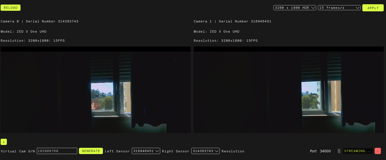

But once I open ZED Explorer, it’s like the exposure is set to a minimum:
Trying to change the exposure manually in the ZED_Explorer does not work - placing it in the maximum does not change anything.

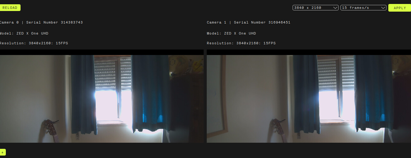

When working without HDR, things are fine. Even changing the exposure of ZED Explorer manually works. Here’s the ZED MEDIA SERVER preview for comparison:
