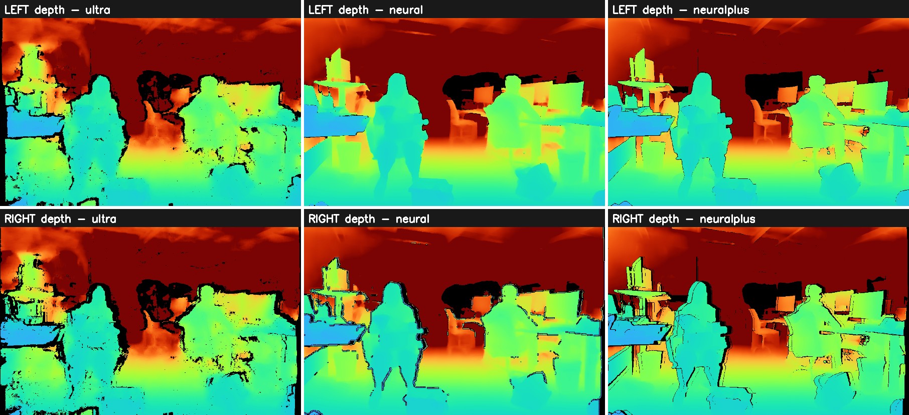

Hi Stereolabs team,
I have a ZED X Mini, and I need a depth map aligned to the right sensor (MEASURE::DEPTH_RIGHT / DEPTH_U16_MM_RIGHT, via InitParameters::enable_right_side_measure = true).
The right-side depth has an interesting appearance / artifact. The left (default) depth of the frame is clean.
I’d like to understand whether this is expected behavior or a known bug for the right-side measure, and whether there’s a recommended way to obtain a right-aligned depth map of equal quality to the left.
Thank you
I’ll post information about my setup below:
  • ZED X Mini (4mm), connected via ZED Link Duo capture card
  • ZED SDK: 5.4.1
  • ZED Link Duo driver 1.4.2-LI-MAX96712-L4T36.4.0
  • NVIDIA Jetson Orin, L4T 36.4.4 (JetPack 6), CUDA 12.6, TensorRT 10.3, GPU driver 540.4.0
  • Depth mode: reproduced on ULTRA (deprecated), NEURAL, and NEURAL_PLUS
  • RuntimeParameters at defaults (confidence_threshold = 95, texture_confidence_threshold = 100), depth_stabilization = 30
