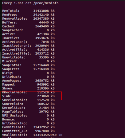

I found a memory leak issue with the ZED X.
When running ZED_Explorer, I noticed that while there is no issue when using the ZED2i, the memory usage increases when using the ZED X.
The slab memory in the screenshot below keeps increasing, and I would appreciate it if you could let me know whether this is a problem or if there is a solution.
The current environment is as follows:
- Camera: ZED X
- Controller: Nvidia AGX Orin 32GB Dev Kit
- Capture Card: ZED Link Duo GMSL2 capture card
- ZED Link Driver Version: 1.3.0
- ZED SDK Version: 5.0
- Jetpack version : 6.2
