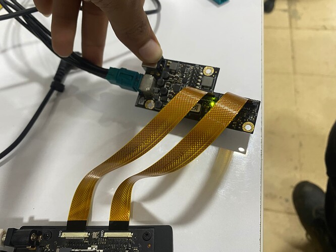

What type of Jetson Orin device are you using? Please send a picture of it.
Is the ZED Link Duo correctly powered as explained in the documentation?
everything was working smoothly but when i installed the new zed sdk 5.0.5 with the latest driver 1.3.1 the issue started popping on the jetpack 6.2.1 and im using jetson orin nano super …
below is the link to the setup ive been using for a while now …
pictures

From your dmesg it appears the driver is working properly but your camera is not detected, this usually indicates a faulty power on the capture card or a disconnected/faulty gmsl cable.
yes the capture card is powered properly …the gmsl cables are fine as i have shared the picture of the setup as well … in fact i changed the cables to make sure if that was the cables that were causing that but they werent

If you have connected the ribbon cables while the capture card or the board was powered on, this can be potentially dangerous and may have damaged the port.
