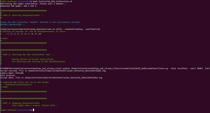

Below is the output I get in the terminal (also attached in the screenshot):
Detected ZED model: ZED X ZED X
# STEP 1: Starting SkeletonTracker …
Using the ZED resolution 'HD1200' defined in the environment variable DEFAULT_RESOLUTION …
# STEP 2: Starting the ROI Calibration Tool …
PYTHONPATH=/home/lm/instorelab/hipe_zed_stream_client python …
Camera Open: FAILURE
Exit program.
So the ROI Calibration script immediately fails because the camera stream cannot be opened.

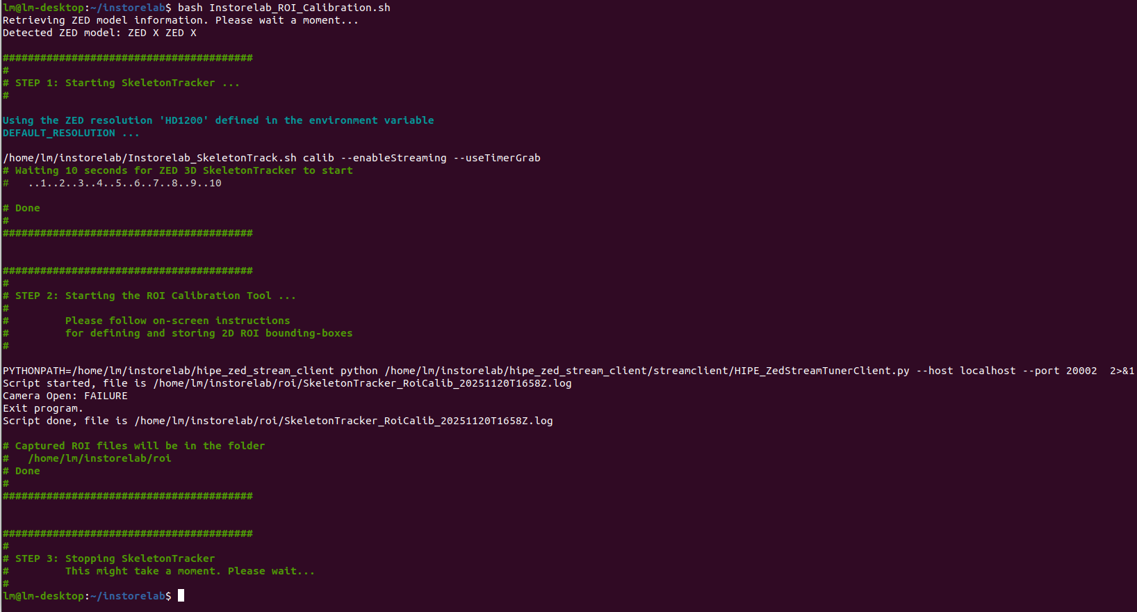

Dear Walter, as you suggested, I have now upgraded the system and am still encountering the same issue:
[cid:db3285b6-82ef-449b-b1b3-7fd9b005f317]
