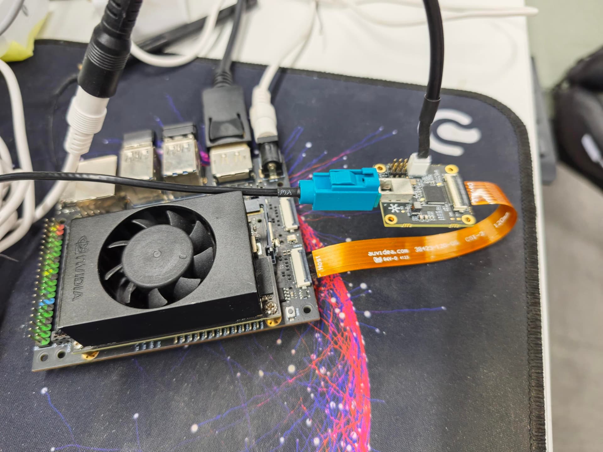

Hi, I also encountered the same problem. My camera was working fine a few days ago, but now, although it shows ”camera availabel” in `ZED_Explorer -a`, the same error message appears when I run the ZED_Explorer. The json file generated by ZED_Diagnostic is as follows. Can you help me locate the problem?

Can you give more information about your hardware: Jetson model, capture card model?
Have you verified the connection between the capture card and the board?
I’m using Jetson Orin NX 8GB connecting a single ZEDX camera with a ZED Link Mono capture card. I have verified the connection, the output of `ZED_Explorer -a` shows that the ZEDX camera is available, so I think the connection should be fine.

What MIPI cable are you using? Anything above 12cm can have an unreliable signal and can introduce noise.
The MIPI cable is about 10cm

Hi @mattrouss ,
I have tried this method, and the result is still the same. Based on the diagnostic results, can you tell whether it is a system problem or a hardware problem?
If you have any suggestions for further debugging, I would be very grateful.
