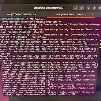

we’re hitting the same `Argus AlreadyAllocated: Device 0 (of 1) is in use` on a ZED Box Mini with two ZED X One GS cameras.
Basically when connecting 1 camera to the ZED box mini and ran the ZED explorer UI, it’s able to detect and stream the video feed.
But when both cameras are connected to the ZED box mini, the explorer UI couldn’t connect to the cameras and timed out with the errors shown in the screenshot.
