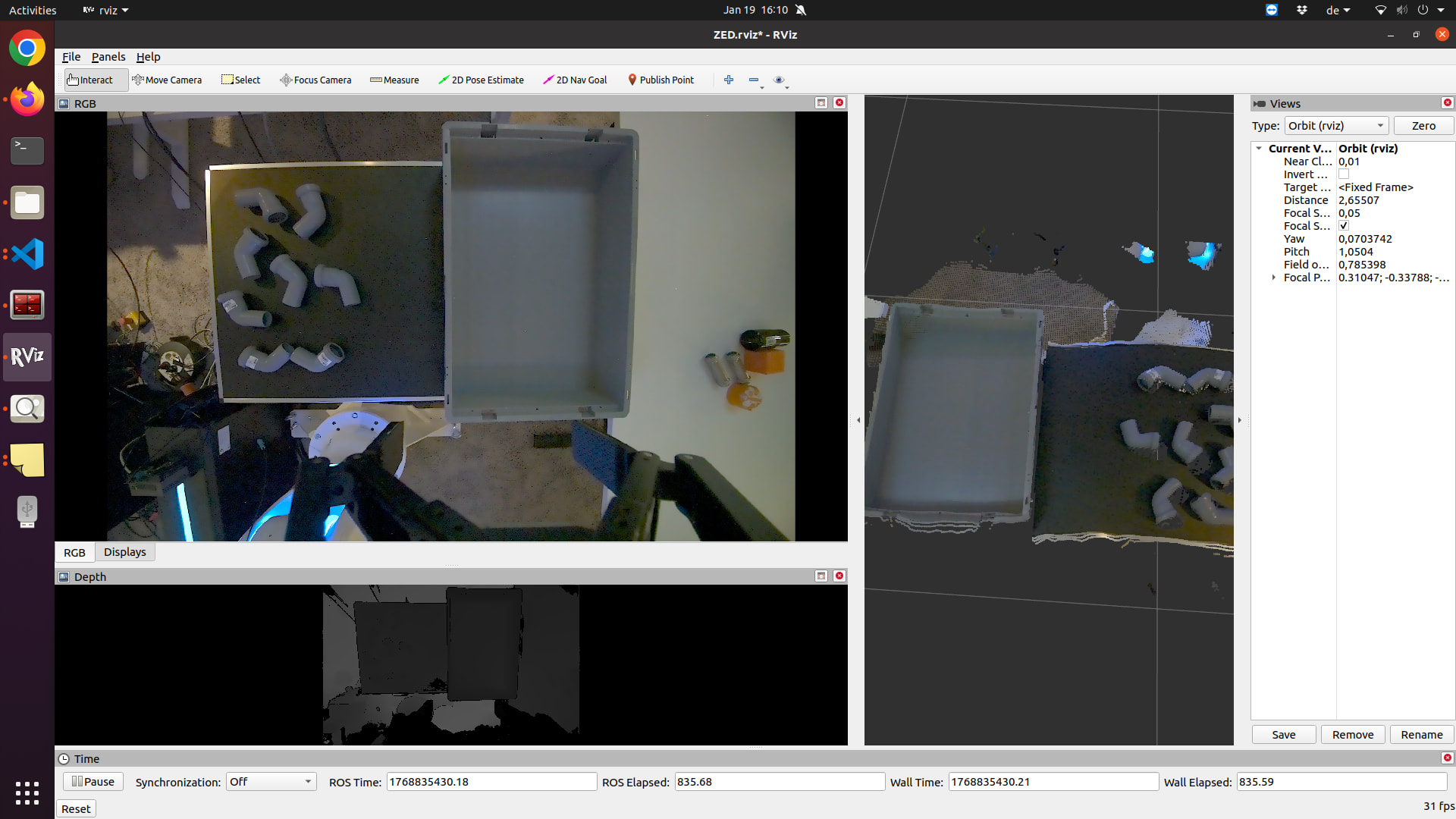

@Myzhar Thank you for your response!:slight_smile: I’ve already experimented with the Denoising setting. It helped a bit after changing the parameter value from 50 to 80 and finally to 100, but overall, the images are still grainy especially in the regions where there are black colors. I am attaching the output after changing the denoising parameter(ros2 wrapper config) to 100 here for your reference(It is the same in the ZED Explorer as well). Is there any other setting that I could try changing?
Normally, this behavior is caused by an automatic increasing of the Gain values (analog or digital) because of low light conditions.
Please try to set the gain to a fixed value or improve the light conditions.
Are you using a polarized camera indoors? Polarized optics slightly reduces the amount of light hitting the CMOS sensors, while this is not a problem outdoors, it can cause grainy images indoors.
I am not using a polarized camera. Also, the room is bright. I will try tweaking the gain values though and get back to you. Thanks for your help!
