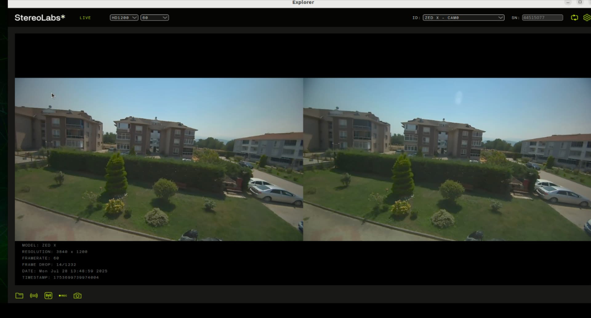

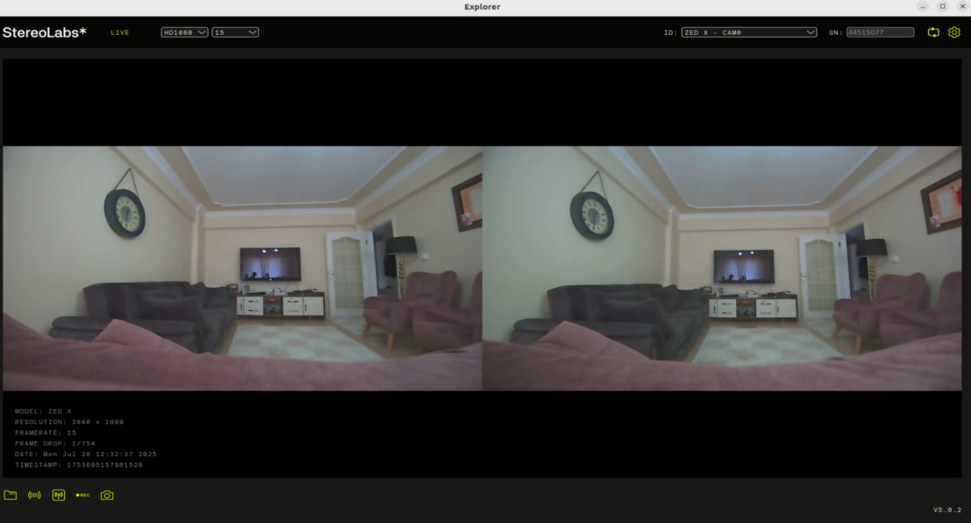

Hi @Myzhar , I have zed x camera and zed box mini Orin NX 16 gb. My system updated. SDK version 5.0.3. & jetpack 6.2 & camera driver 1.3.1 and zed x camera blurry/soft image problem exists. For this problem is my driver should be 1.2.2 to fix.
No, the ZED X Driver v1.3.1 also contains the fix.
Please send pictures to show your problem. Maybe it’s caused by something different.
Hi, it says new users can’t uploads attachments when I want to upload video.
So I upload an only one screenshot. As you can see, there are some places very blury and also there is some noise , tingling nose in the image.
Zed x camera with polarizer and wide lens, mini box orin nx16gb
Polarizers are not meant to be used indoors with dark scenes.
You should use polarized cameras outdoors in sunlight conditions
Thank you for quick reply.
I tried for outdoor. But somehow I think it is blury, not sharpened. Is this the final image result of zed x camera. Are there any configuration suggestion, I would expect glass-clear image quality.
Please record a short SVO in both indoor and outdoor conditions and send it to support@stereolabs.com
