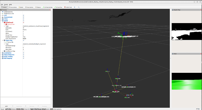

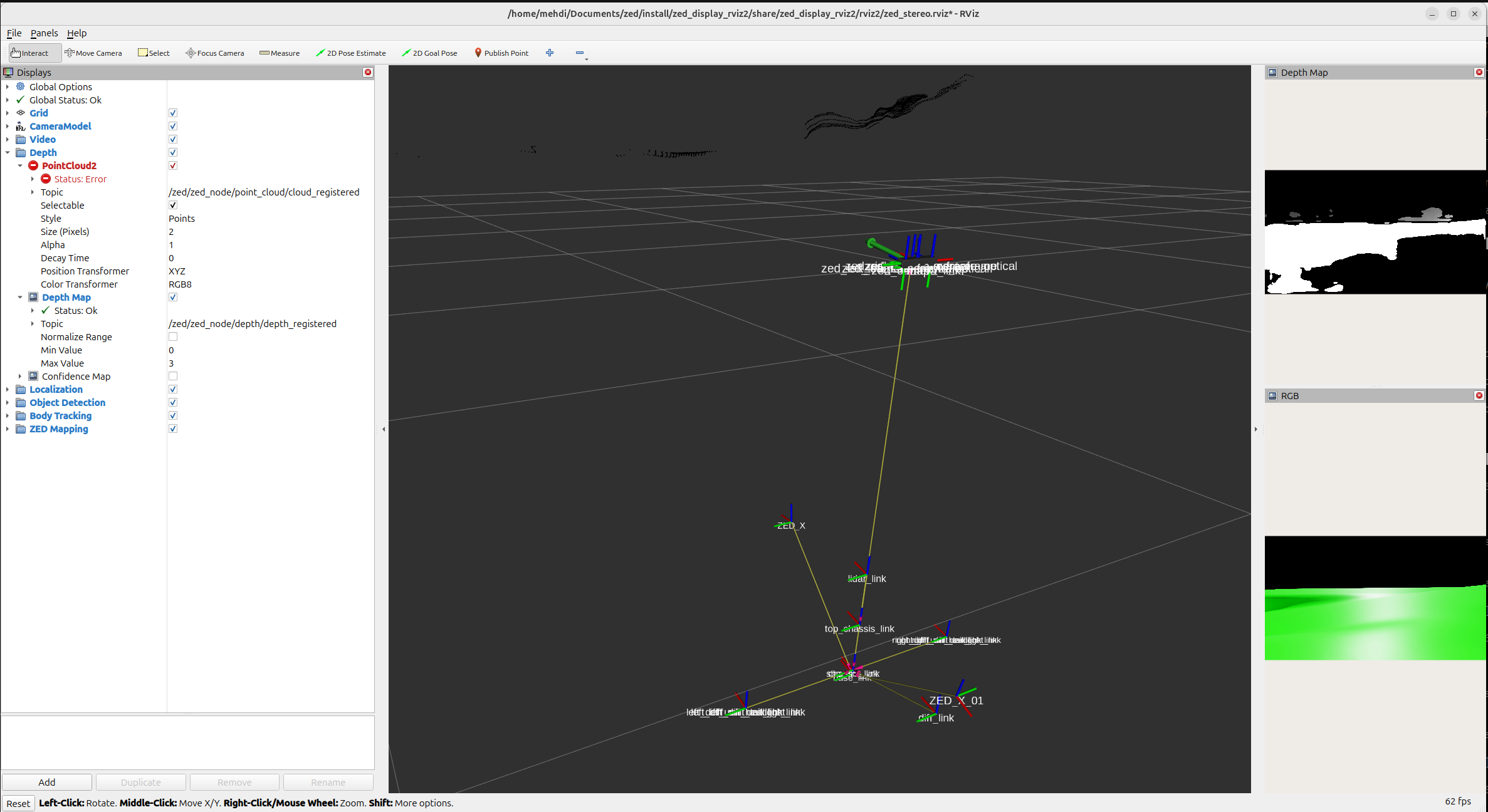

RViz : zed_camera_center floating above the robot
In RViz, the wrapper’s zed_camera_center frame appears far above the robot body (see screenshot). This also causes the registered point cloud topic (/zed/zed_node/point_cloud/cloud_registered) to report a Status: Error because the transform chain from the point cloud frame to the fixed frame is broken.

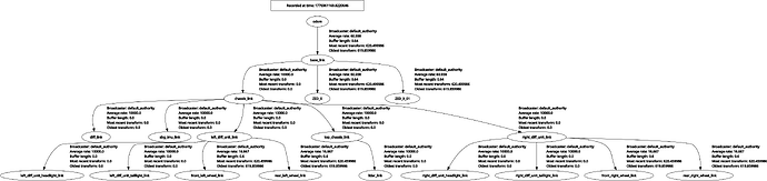

Isaac Sim only (before launching wrapper):
odom → base_link → ZED_X → chassis_link → [wheel/sensor links]

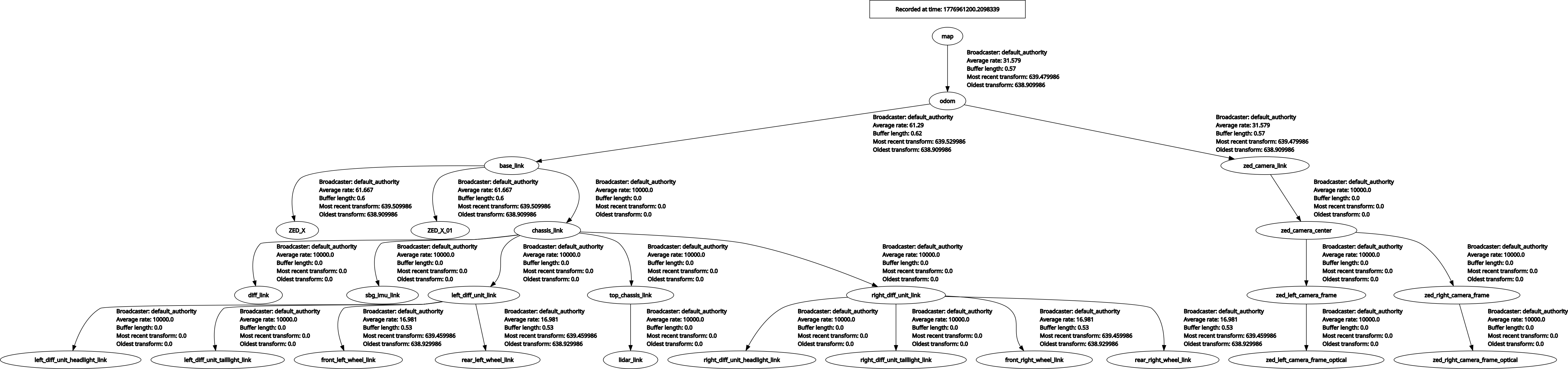

After launching wrapper:
The wrapper injects an additional subtree under odom:
odom → zed_camera_link → zed_camera_center → zed_left_camera_frame / zed_right_camera_frame
Both subtrees are reachable from odom, but the wrapper’s camera frames are not anchored to base_link and are spatially incorrect.
