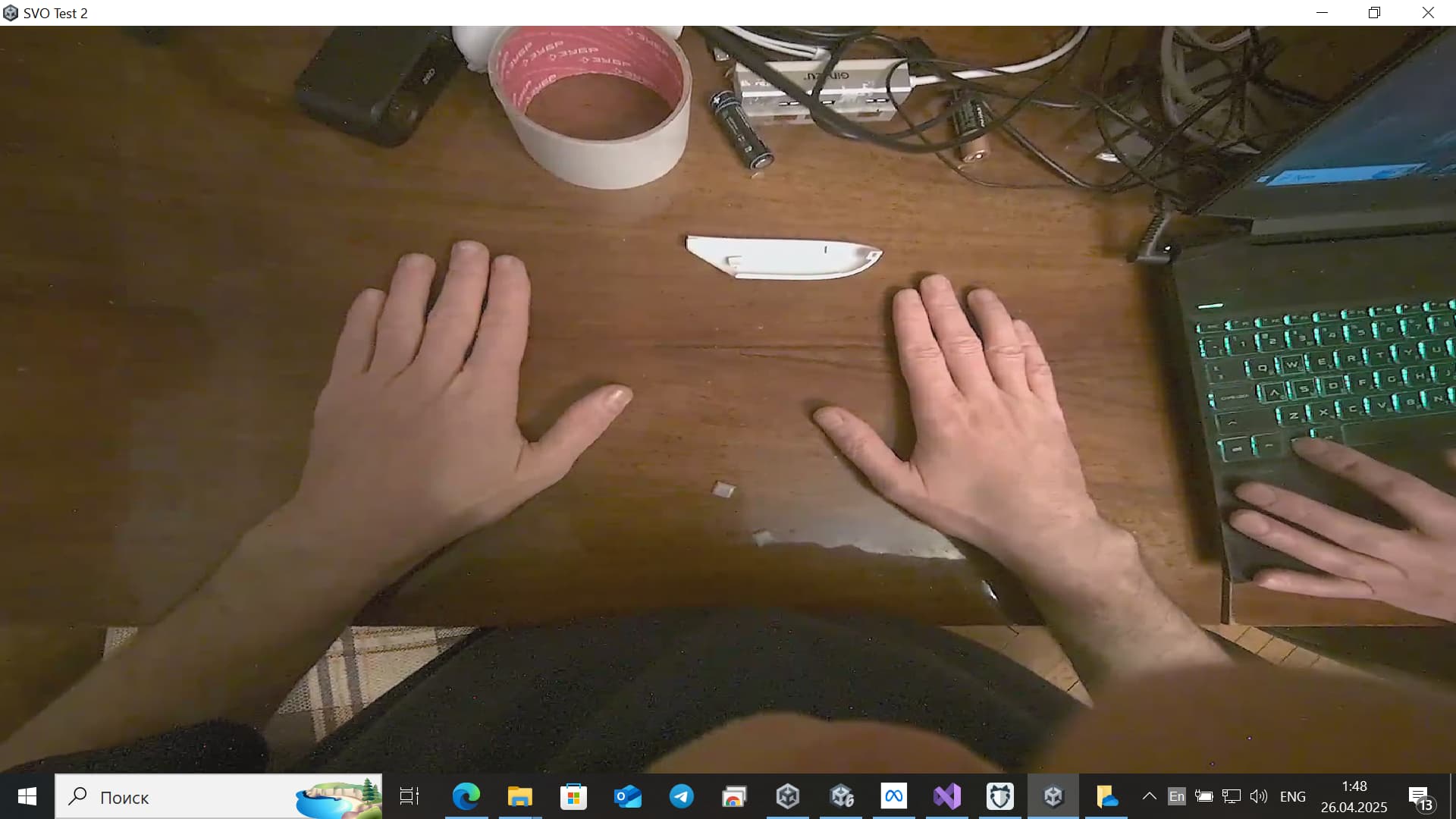

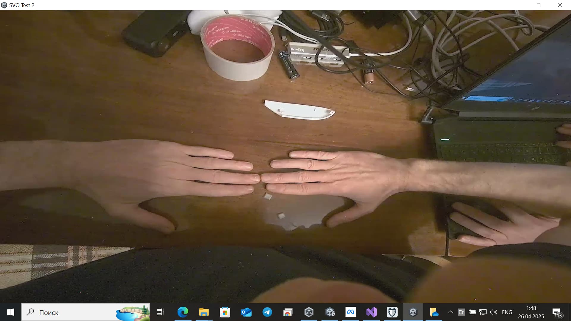

However, we’ve run into another concern: when moving objects (for example, hands) left or right of the screen center, the fingers and hands become excessively stretched horizontally, whereas the same objects appear noticeably squashed near the center. In other words, the plugin seems to over-scale the image horizontally, distorting object proportions.
To troubleshoot, we have tried:
  • Switching the Stream resolution from 1920 × 1080 to 2134 × 1200
  • Toggling between different Depth Modes (performance, quality, ultra etc.)
  • Setting Depth Submission Mode to “Depth 24 bit” instead of “None” (we’re using OpenXR)
Unfortunately, none of these changes have alleviated the stretching.

The image from the zed x mini is equally distorted (enlarged and stretched) when using different depth modes as well as using the oculus provider. So it’s not about Open XR. For the sake of interest I tried to run the build with the old zed, via usb. There it turned out the opposite - the image is greatly reduced - the body of a dwarf :slight_smile:
