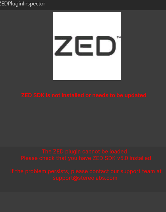

I’m on Windows 11, having this issue.
When launching a project with the latest zed-unity package from github I get this message in Unity. I have the latest SDK (5.0.2) installed. Depth Viewer f.e. is running just fine.
Any idea how to troubleshoot this?

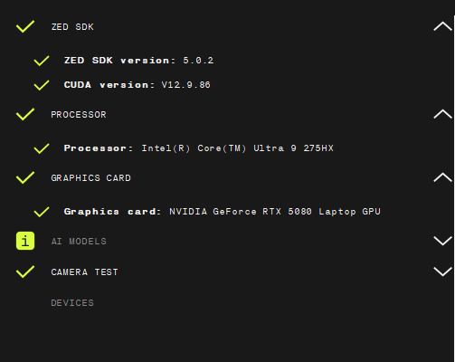

The diagnostic tool seams to crash. It checks everything until the step Devices and then just closes.
(same after uninstalling and installing the SDK from scratch, which I just tried)

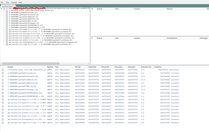

Do you have, by any chance, Dependancy walker installed on your machine? (https://github.com/lucasg/Dependencies)
If so, you could open the slèunitywrapper.dll lib with it and share a screenshot of the result?
You can find it at My project\Library\PackageCache\com.stereolabs.zed\SDK\Plugins\x86_64
Stereolabs Support

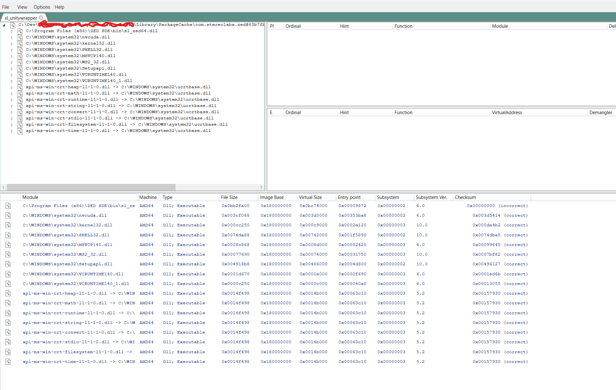

Yes, sure. here you go. Is that what you need?

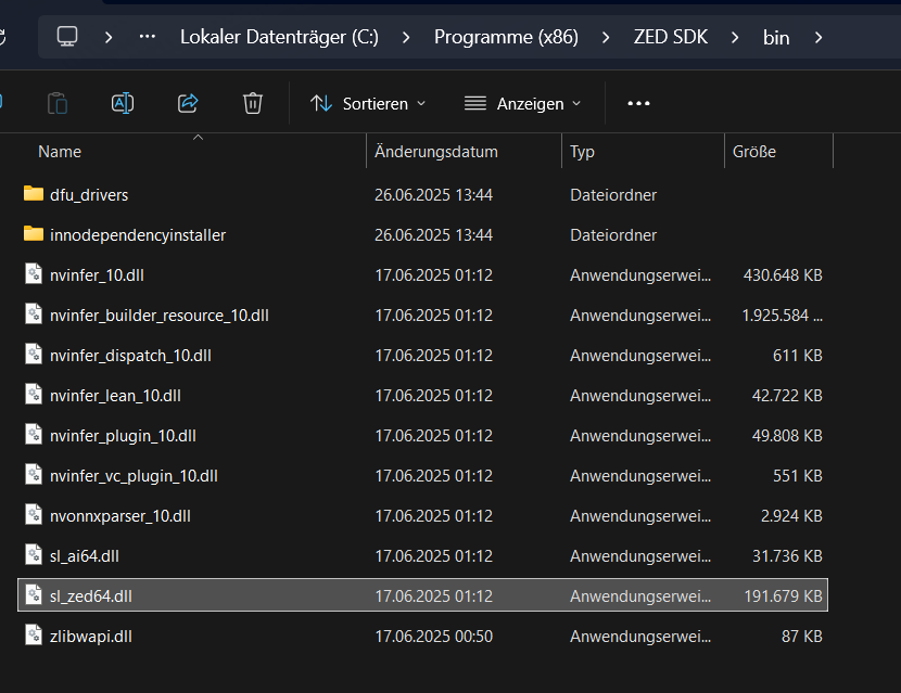

Is the sl_zed64.dll showing as incorrect an issue? File is there and it’s not empty at least :sweat_smile:
Maybe also relevant, it not only happened on this laptop. I also tried installing 5.2.0 SDK on my older machine, where the latest Unity SDK failed to find it as well.
Thanks, that’s perfect. Everything looks fine, it manages to load the lib from the ZED SDK.
