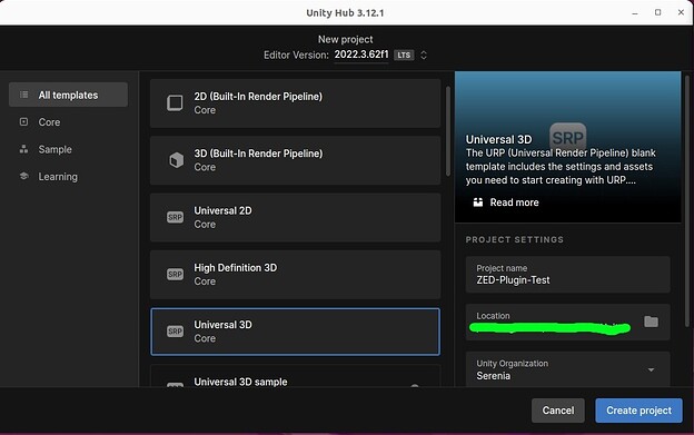

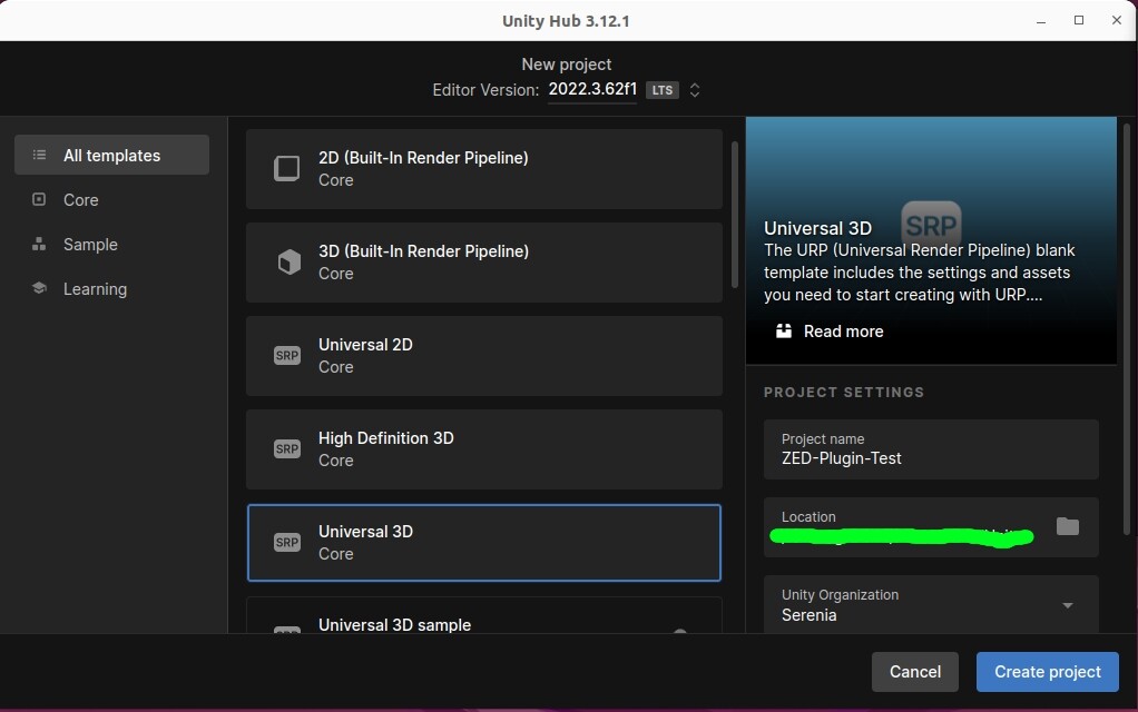

My problem is, when I create a unity project using the 2022.3.62f1 LTS version and the
Universal 3D Core Template;
I go to Window > Package Manager
I click on the + icon then add the link here for installing from git

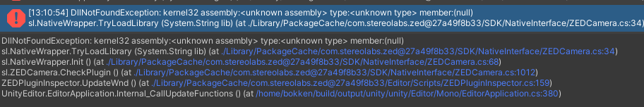

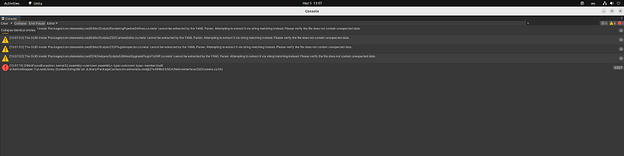

After the SDK plugin is installed I repeatedly get the error below and in some instances it crashes my system.

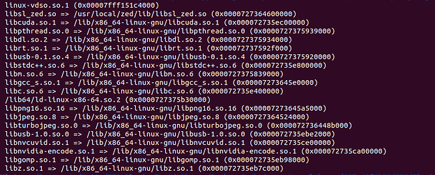

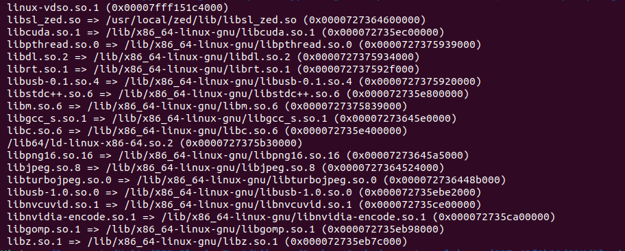

In another issue (maybe not related) someone asked to see the ldd libsl_unitywrapper.so output so I am putting it here just it case.

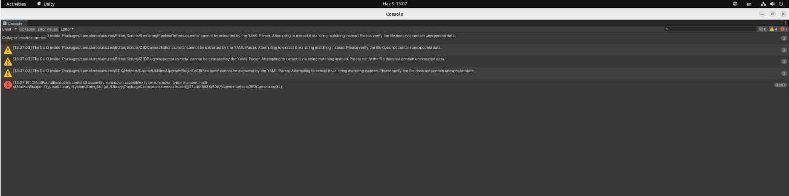

The DllNotFoundException: kernel32 error appears in the Unity Editor on Linux when the ZED Unity Plugin is imported, even if no ZED SDK is installed on the system. This happens after ensuring all C# within the plugin compiles (e.g., by conditionally compiling out XR dependencies if the XR package is not installed) and all native library assets within the plugin are correctly configured for their respective platforms in Unity’s inspector
  • I have managed to make an older setup work with ZED SDK 4.2.5, Unity6 and Plugin 4.2.5 but the same error persists on higher plugin setups.
