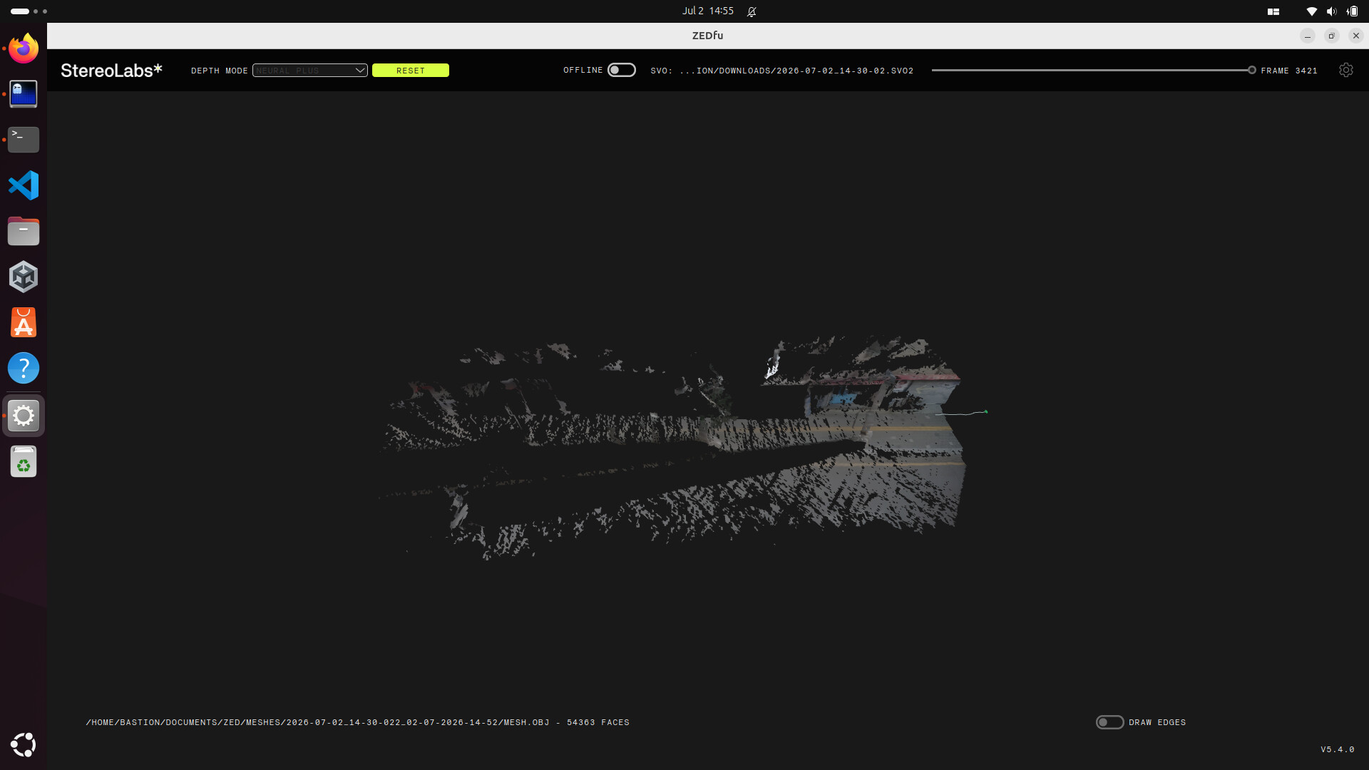

So I can get texture scans. but when I run it, I get a very patchy output. When I disabled the filter and the texture, the output obj is very complete but when I try to apply the filter, big parts of the scan ended up missing.
I used ZED X with a Jetson orin nano running on a battery to film an .svo2 file at SVGA resolution (the Jetson Orin Nano also is running at MAXN) and I run the spatial mapping program on my laptop with AMD Ryzen 7 260 and 32GB RAM. Both Jetson and laptop is running ZED SDK version I tried filming the svo longer, adjust the resolution, and using ZEDfu. Nothing seems to work and the result from ZEDfu ended up looking pretty simiilar to the one from the tutorial program. My ZED_Diagnostic is normal.
this is the picture of the mesh before applying texture from ZEDfu

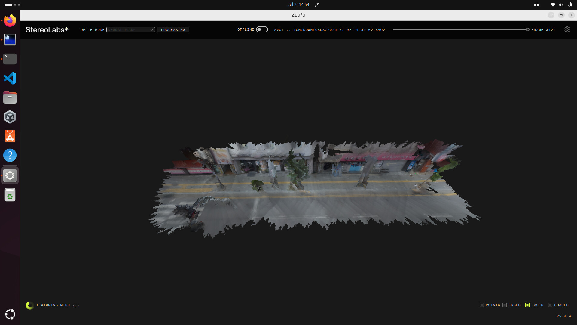

this is the mesh after applying the texture from ZEDfu

Initially when I was looking at the textured mesh, it appeared that the mesh was only appearing in areas which were “seen” in the initial pose of the camera at the first frame. The obvious “cone” shape on the right of punnlert’s second image is what I was seeing as well and that cone usually looked somewhat similar to the FOV of the camera. But when I tried more scenes from other SVO files, it seems more complex than just only things in the first frame having texture. I did a test with two rooms in a building that share a common wall. In one room the wall is painted gray, and in the other room the other side of that same wall is painted light green and has a TV mounted on it. The SVO starts with the camera in the first room with the gray wall. The second room is not visible in the SVO until about halfway through the recording. But when a textured mesh is created in ZEDfu, both sides of the wall are present, the gray side and the green side with the TV visible. Obviously the green side and the TV weren’t “seen” in the first frame of the SVO, but they still appeared in the textured mesh. Note that this behavior of the back side of objects being present in the textured mesh seems to be some what random and difficult to consistently reproduce.

I understand that filtering and scanning speed can affect the completeness of the scan but why would only the area “seen” in the initial pose of the camera properly generated like how I and @sothos observed. I find it weird that there is a cone pattern of casted occlusions of holes in the filtering scan. Shouldn’t the incompleteness be more uniformly distributed if that is the case? It appears that no matter how long the .svo2 file is, only the initial area is properly filtered and textured. Also, why did changing the tracking algorithm from GEN_3 to GEN_1 produce a more complete result if the problem is MESH_FILTER::LOW ?
You’re right, and thanks for pushing on this — those two observations are the key ones. A cone of coverage anchored to the initial camera pose, and GEN_3 → GEN_1 restoring completeness, both rule out mesh filtering as the primary cause. Filter strength does delete disconnected islands (so keeping MESH_FILTER::LOW is still worthwhile), but it can’t explain a pattern that’s tied to the starting pose or that changes with the tracking generation. So our earlier explanation only covered a secondary effect — apologies for that.
The real cause is on our side: the spatial mapping module is currently built and validated around GEN_1 positional tracking. With the newer generations (GEN_3), later camera poses aren’t integrated into the fused map as effectively, so coverage collapses back toward the initial reference frame — which is exactly the initial-pose cone you and @sothos are seeing, and why GEN_1 gives a far more complete result regardless of how long the recording is.
