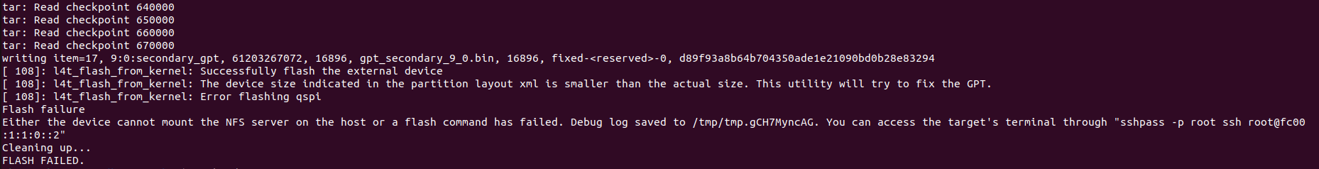

I tried downgrading to JetPack 6.0 by following the instructions in this guide:
https://www.stereolabs.com/docs/embedded/zed-box-orin/reset-update#flashing-the-zed-box-orin-model
However, I encountered a problem as shown in the attached image
I also tried the suggested fix from this thread, but it still didn’t work:
https://community.stereolabs.com/t/zedbox-orin-flash-failure-qspi-error/10461/3
Hi @patcharapon-fullstac
Are you using a ZED Box Orin or a ZED Box Mini?
@Myzhar I am using a ZED Box Orin.
usually, specifying a partition size in the script by adding in the flash command (for example, -S 28GiB) can resolve this kind of issue.
