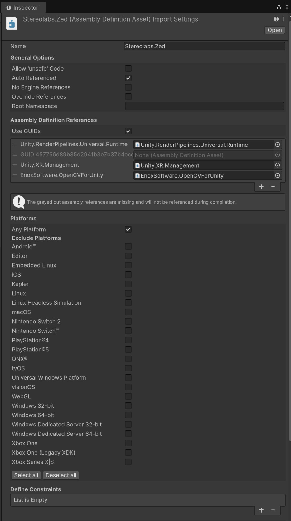

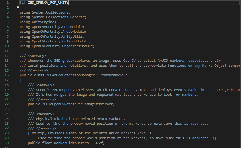

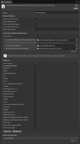

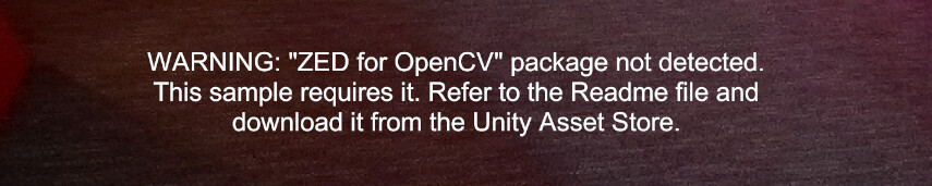

I’ve attached a screenshot of the StereoLabs.Zed Assembly Definition Asset. In the past, adding EnoxSoftware.OpenCVForUnity to the Assembly Definition References has resolved this issue, but that solution no longer seems to work. I’ve also attached a screenshot of the warning message and a snippet of the code from ZEDArUcoDetectionManager.cs showing that #if ZED_OPENCV_FOR_UNITY doesn’t equate to true so the code stays unactive

The assembly reference is required, but it is not what sets the symbol, so it cannot fix this alone. In plugin 5.4.0 the ZED_OPENCV_FOR_UNITY symbol is managed by ZEDDefineHandler.cs (SDK/Helpers/Scripts/Utilities/). It runs on every domain reload and after every asset import, and it looks for a loaded assembly whose name is exactly opencvforunity:
csharp
const string OpenCVAssemblyName = "opencvforunity";
if (assembly.GetName().Name.Equals(name, System.StringComparison.OrdinalIgnoreCase))
If the assembly has a different name, for example EnoxSoftware.OpenCVForUnity as used by recent OpenCV for Unity releases, the comparison fails, so the define is never added; worse, RemoveDefine() strips it from the Player Settings if you add it by hand. This matches exactly the symptom you observe with OpenCV for Unity 3.0.3.

  1. Select the OpenCV for Unity Assembly Definition Asset and read its Name field (or check the DLL name in Library/ScriptAssemblies/). That is the string the handler must match.
  2. Make sure the reference is added to the assembly that actually contains ZEDArUcoDetectionManager.cs. When the samples are imported from the Package Manager, that is Stereolabs.Zed.Examples, not Stereolabs.Zed.
