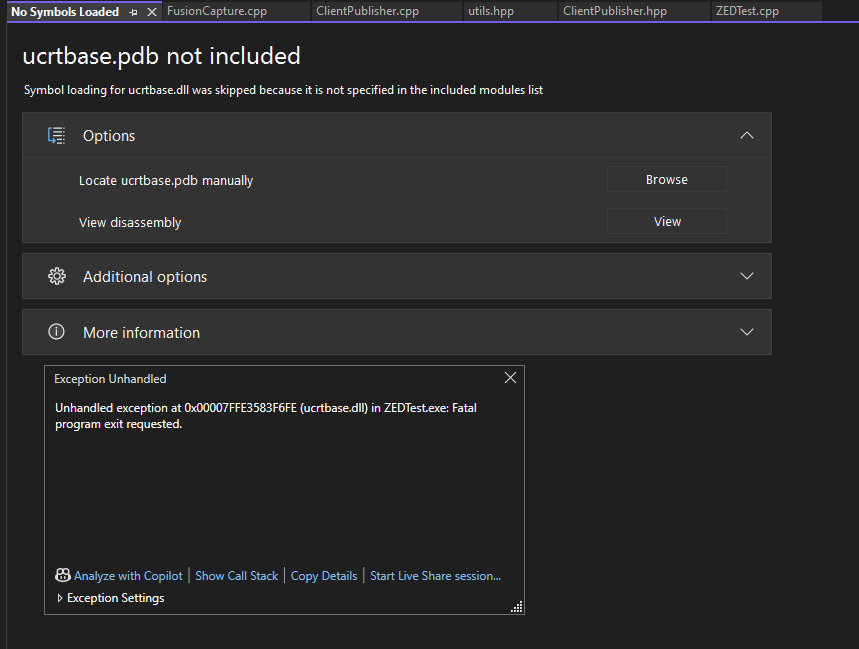

I am currently using the ZED SDK 5.0 in conjunction with two ZED 2i’s. I am experimenting using the Fusion API in C++ to perform some basic spatial mapping with the two cameras before I move on to more advanced use cases through the Fusion API. I’ve written some basic code, which I will attach below, with some minor tweaks while referring to the examples provided in the Git repository. However, every time I run the code, I get an unhandled exception saying “ucrtbase.pdb not included”. I predominantly use the Python version of the API to develop, and I believe not all of the Fusion API is ported to Python as of yet? As I could not access certain methods that are accessible through the C++ API. I have more experience using the Python API and very little using the C++ side of things. I wanted to know if anyone else was facing this issue, and if so, what they did to counter it. Any help would be appreciated.

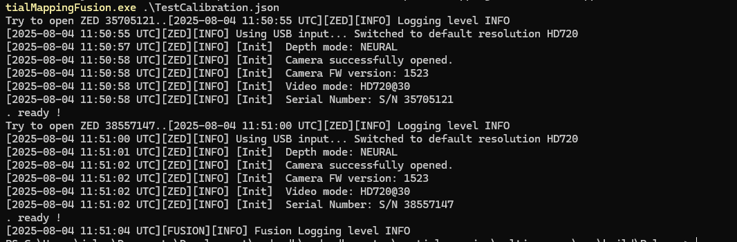

Yes, certainly. I have tried building the official C++ sample that you have linked, and I do manage to build it just fine. I have run it, and it opens the OpenGL viewer. However, it runs for around 5-10 seconds and then just shuts down. I will attach a screenshot of the logs I receive before it shuts down. Since it’s a standalone executable, I’m unable to see any errors as to why it shuts down there, but I reckon it is related to the ucrtbase.pdb not included error I’ve been receiving in my other project, and it seems to occur shortly after the Fusion engine is initialised. I will attach a screenshot of this error in a subsequent reply as I am only able to post one embedded image for the time being. I have tried to uninstall and reinstall my C++ redistributable, because I thought this error was related to the Universal C Runtime library, but that did not seem to help unfortunately. Let me know if you need any other information from me, or if anything is unclear. Thanks in advance.
Here is the screenshot of the ucrtbase.pdb error.
