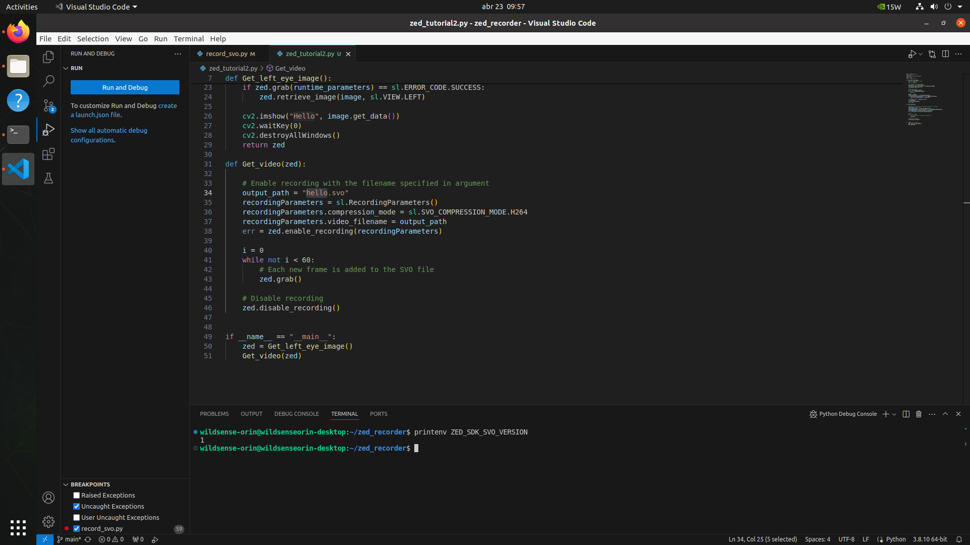

Hi @mattrouss,
I tried changing the enviroment variable as seen in the next image
But the issue persists. Upon executing the .enable_recording() method, as shown in the next image:
The jetson completely freezes to then proceed to restart after 1 min app.
Am I setting it wrong?
Update: I verified that the environment variable is set to 1 and implemented some writting to the syslog to try to see what happened in the background. The modified code is the following:

I’ll try in another jetson Orin Nano and to go back to SDK 4.0.8 to see if the problem persists.
Hi @NVG97,
Sorry for the late reply, and it appears I was not clear in my previous message.
The only compression mode available on Jetson Orin Nano is the SVO_COMPRESSION_MODE::LOSSLESS. Can you please set this mode in your script and try again?
Thank you! That solved it.
What Jetsons are able to run H265 compression mode?
Glad to hear this was the issue.
Jetson Orin Nano is the only one with this constraint as it does not have any hardware encoders to perform H264/H265 encoding on its GPU.
Hi again @mattrouss,
I would like to know if there are any plans of being able to achieve LOSSY compression modes using only software, hence being able to use H265/H264 compression modes on the Jetson Orin Nano. The company already purchased several Orin Nano anticipating to use them as main hardware in the project I’m workin on and part of that implied to use .svo files small in size.
Additionally, Where in the documentation is it said that LOSSLESS compression is the only available mode for Orin Nano?
Thank you again for your time.
Hi @NVG97,
I’ve asked our technical team and we are indeed planning software encoding for the next release of the ZED SDK, specifically for your use case using the Orin Nano which lacks hardware encoding.
I would like to mention that this type of encoding will come with a non-negligible CPU overhead.
I agree with you, the documentation is not clear that an NVENC hardware encoder is required, which the Orin Nano lacks. I’ve logged the issue to fix the crash that you’ve reported and provide more user friendly logs on why the recording does not work, and also improve the documentation related to this.
