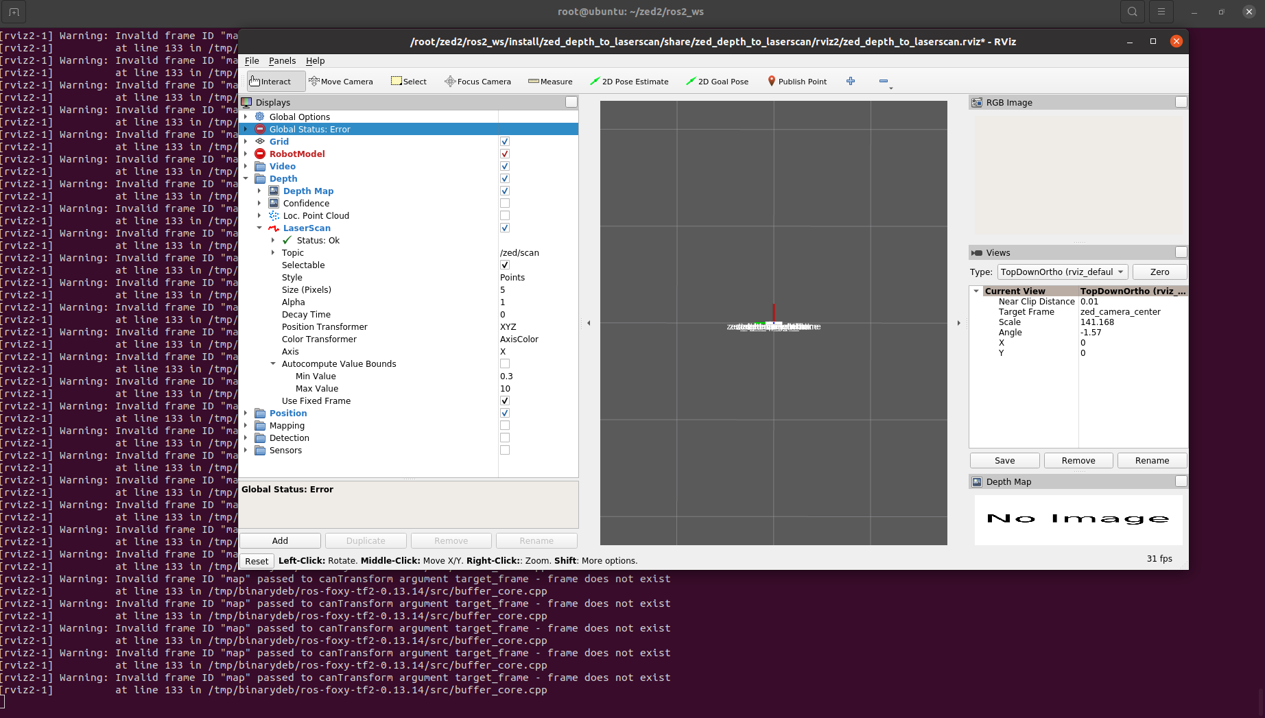

And I ran the zed_depth_to_laserscan example. But the /zed/scan topic is not published.
(terminal1)
ros2 launch zed_wrapper zed_camera.launch.py camera_model:=zed2
The log that appears in the terminal window after execution is as follows.
[INFO] [launch]: All log files can be found below /root/.ros/log/2024-06-01-04-52-22-623023-ubuntu-170284
[INFO] [launch]: Default logging verbosity is set to INFO
[INFO] [robot_state_publisher-1]: process started with pid [170287]
[INFO] [zed_wrapper-2]: process started with pid [170289]
[robot_state_publisher-1] Parsing robot urdf xml string.
[robot_state_publisher-1] Link zed_camera_center had 4 children
[robot_state_publisher-1] Link zed_baro_link had 0 children
[robot_state_publisher-1] Link zed_left_camera_frame had 2 children
[robot_state_publisher-1] Link zed_left_camera_optical_frame had 0 children
[robot_state_publisher-1] Link zed_temp_left_link had 0 children
[robot_state_publisher-1] Link zed_mag_link had 0 children
[robot_state_publisher-1] Link zed_right_camera_frame had 2 children
[robot_state_publisher-1] Link zed_right_camera_optical_frame had 0 children
[robot_state_publisher-1] Link zed_temp_right_link had 0 children
[robot_state_publisher-1] [INFO] [1717217543.029133016] [zed.zed_state_publisher]: got segment zed_baro_link
[robot_state_publisher-1] [INFO] [1717217543.029443228] [zed.zed_state_publisher]: got segment zed_camera_center
[robot_state_publisher-1] [INFO] [1717217543.029469181] [zed.zed_state_publisher]: got segment zed_camera_link
[robot_state_publisher-1] [INFO] [1717217543.029483485] [zed.zed_state_publisher]: got segment zed_left_camera_frame

(terminal2)
ros2 launch zed_depth_to_laserscan zed_depth_to_laserscan.launch.py camera_model:=zed2

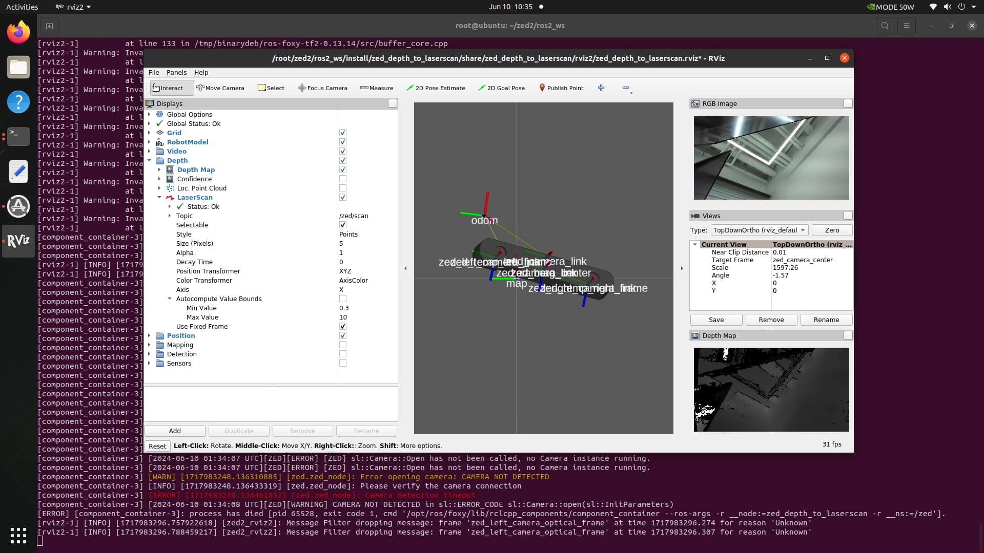

[component_container-3] [INFO] [1717217563.016299207] [zed.zed_node]: ***** STARTING CAMERA *****
[component_container-3] [INFO] [1717217563.016338919] [zed.zed_node]: ZED SDK Version: 4.1.2 - Build 88406_f27a1ebf
[component_container-3] [INFO] [1717217563.022106321] [zed.zed_node]: *** CAMERA OPENING ***
[rviz2-1] [INFO] [1717217563.635655104] [rviz2]: Stereo is NOT SUPPORTED
[rviz2-1] [INFO] [1717217563.635983300] [rviz2]: OpenGl version: 4.6 (GLSL 4.6)
[component_container-3] [2024-06-01 04:52:43 UTC][ZED][INFO] Logging level INFO
[rviz2-1] [INFO] [1717217563.699981367] [rviz2]: Stereo is NOT SUPPORTED
[rviz2-1] Parsing robot urdf xml string.
[component_container-3] [WARN] [1717217564.458242819] [zed.zed_node]: Error opening camera: CAMERA NOT DETECTED
[component_container-3] [INFO] [1717217564.458411781] [zed.zed_node]: Please verify the camera connection
[component_container-3] [2024-06-01 04:52:44 UTC][ZED][WARNING] CAMERA NOT DETECTED in sl::ERROR_CODE sl::Camera::open(sl::InitParameters)
[rviz2-1] [INFO] [1717217564.749367474] [rviz2]: Stereo is NOT SUPPORTED
[rviz2-1] [INFO] [1717217564.869002478] [rviz2]: Stereo is NOT SUPPORTED

It seems that the ZED Node crashed by opening the camera.
Is the camera working?
Can you open it with ZED_Explorer and ZED_Depth_Viewer?
When running ZED_Explorer and ZED_Depth_Viewer in /usr/local/zed/tools, the camera works normally.
Is it correct to run both ros2 launch zed_wrapper zed_camera.launch.py ​​camera_model:=zed2
and ros2 launch zed_depth_to_laserscan zed_depth_to_laserscan.launch.py ​​camera_model:=zed2?
When executing zed_depth_to_laserscan, the RGB Image and Depth Map windows in rviz display images. However, they are not converted to scan data.
I am getting camera detection timeout error and component_container-3 error.
This is not correct.
The launch command ros2 launch zed_depth_to_laserscan zed_depth_to_laserscan.launch.py ​​camera_model:=zed2 already starts a ZED Node by using composition.
Please read the README file with attention for details.
If you only run ros2 launch zed_depth_to_laserscan zed_depth_to_laserscan.launch.py ​​camera_model:=zed2, RGB Image and Depth map do not appear in rviz.
And

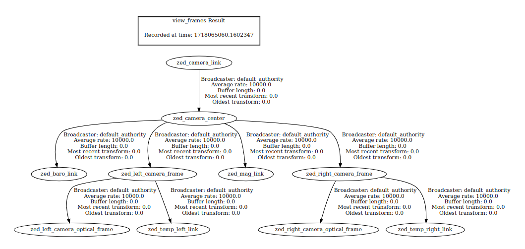

[rviz2-1] Warning: Invalid frame ID "map" passed to canTransform argument target_frame - frame does not exist
[rviz2-1] at line 133 in /tmp/binarydeb/ros-foxy-tf2-0.13.14/src/buffer_core.cpp
The corresponding log is displayed.
The map is not displayed in the tf tree either.
You can manually add all the viewers you need in RVIZ2. What we provide are simple examples of viewer configurations.

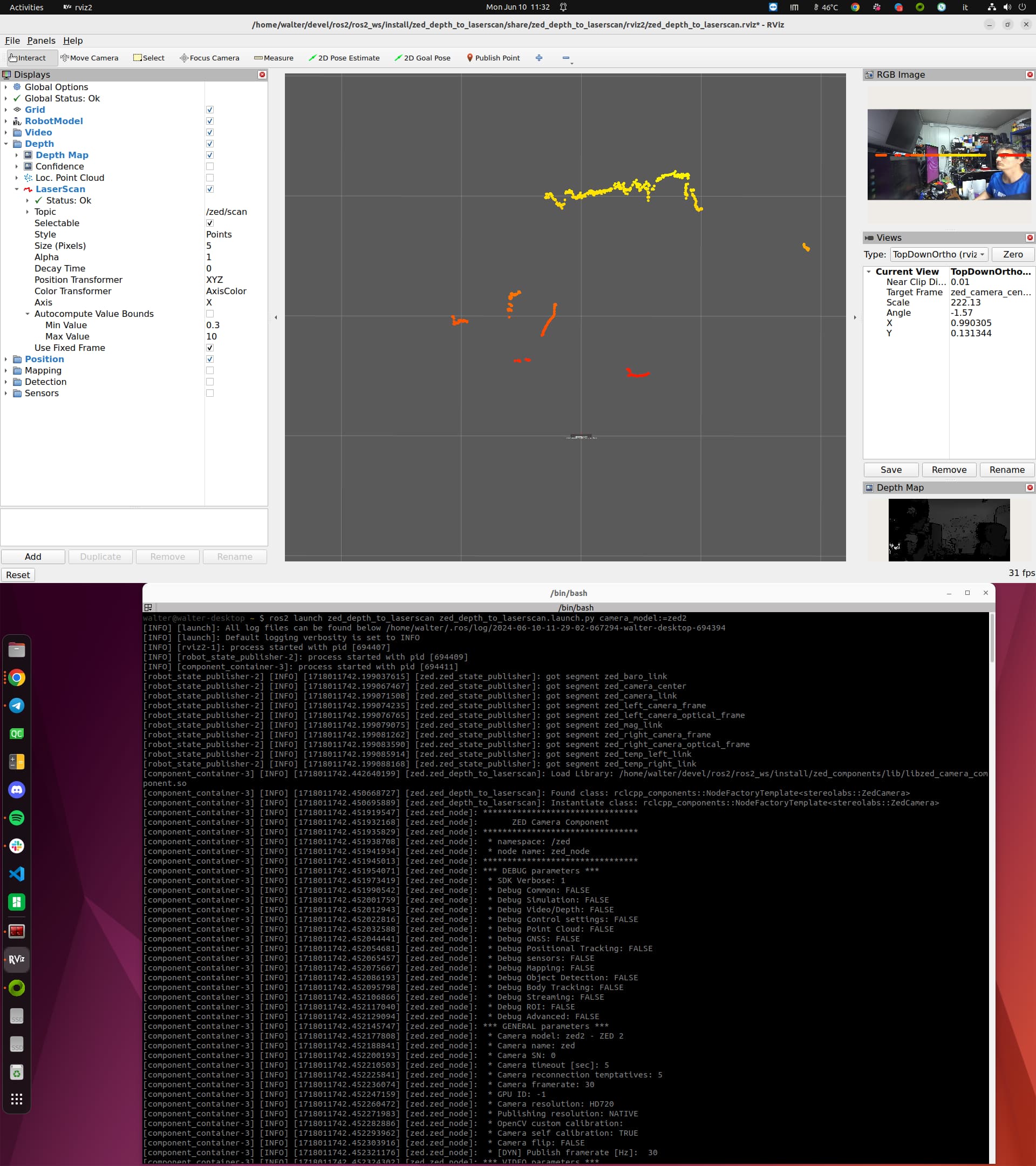

In any case, I just tested the package as is with a ZED2 and it works as expected:
Have you modified something?

And map and odom are not shown in tf tree.
You modified something because this error is not expected.
Can you compare your local branch with the online repository content?
I downloaded the master branch of https://github.com/stereolabs/zed-ros2-examples and ran it right away. I didn’t modify any code.
The problem seems to be in the zed-ros2-wrapper package.
Can you please update it?
Please also delete the build and install folders and build your workspace again to be sure to update all the packages.
I deleted zed-ros2-package and rebuilt it, but I get the same error.
docker image : stereolabs/zed:4.1-tools-devel-l4t-r35.4
ROS2 version : foxy
It doesn’t work properly inside the docker.
I recommend you use Humble inside Docker, not Foxy.
Please use our Dockerfile as an example:
Current orin operating system: Ubuntu 20.04
Can I just create a container using the stereolabs/zed:4.1-tools-devel-l4t-r35.4 image and immediately install humble?
Or should I also install 22.04 in the docker container?
You are on a Jetson, so the Docker image must be based on the same Jetpack version running on the host.
The Dockerfile in the zed-ros2-wrapper repository uses ROS 2 Humble installed from the source.
