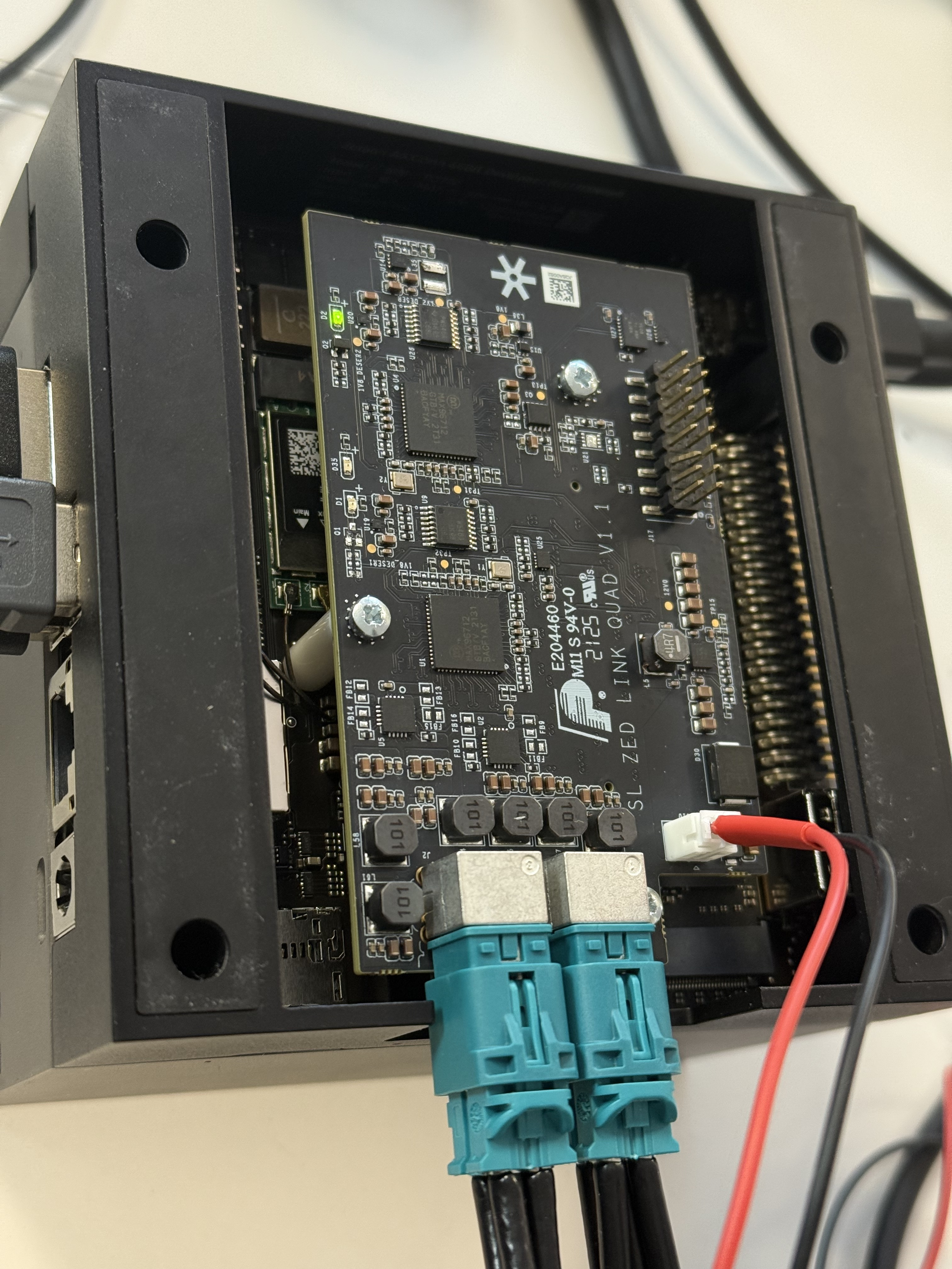

Please send pictures showing your capture card installed with all the connections.
Please also follow the installation and troubleshooting guides.

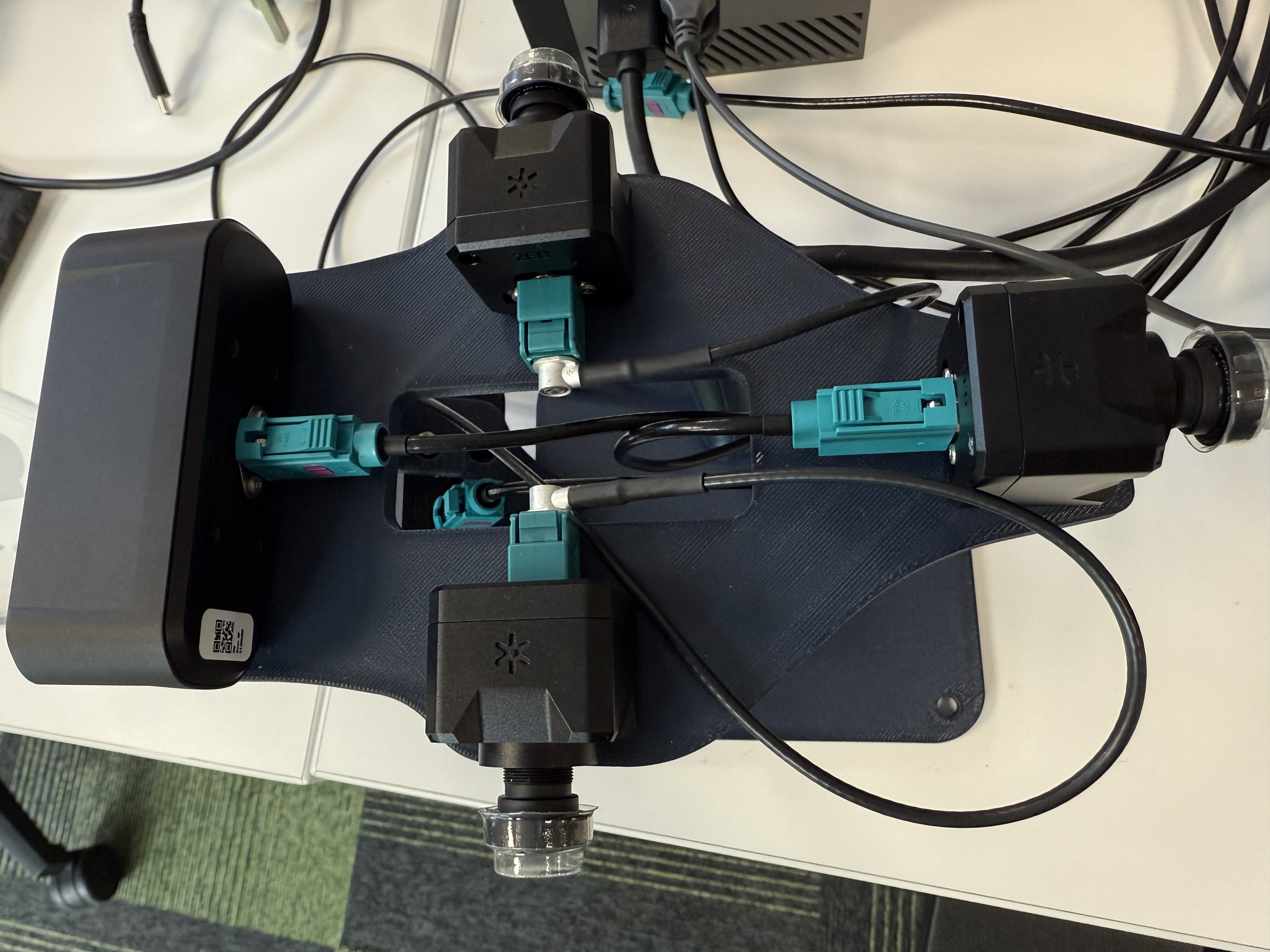

I followed all the instructions perfectly and that can be seen in the image.

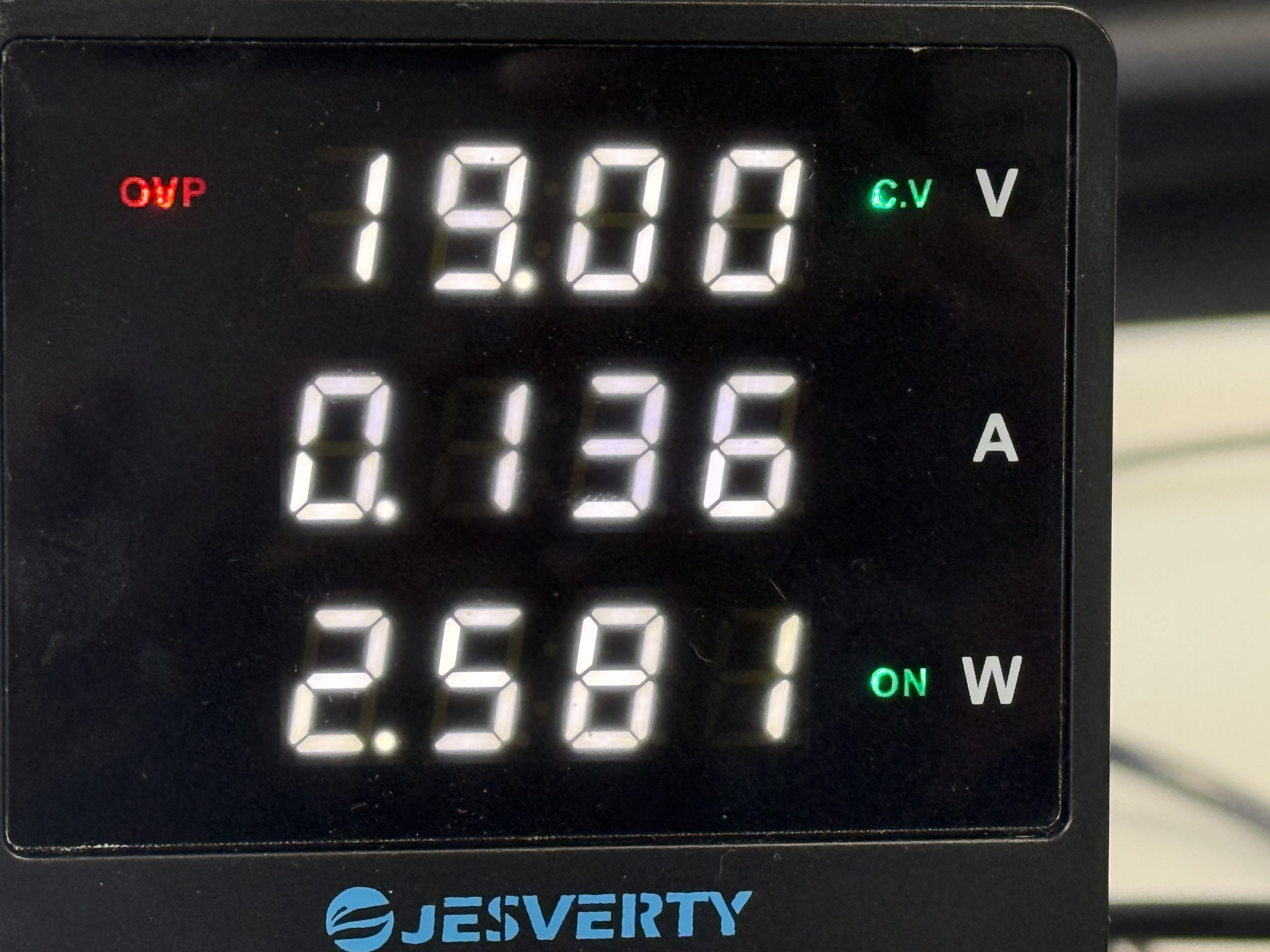

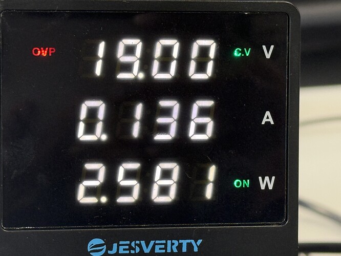

FYI, Power supply I used is a PSU and I set it to 19v manually and gave power to the board. Could it be because of that ? As seen from the image, power is being drawn. But it’s very less. Could it be the issue ?
Are they all ZED X One GS? I cannot understand from the picture if you are using a ZED X One 4K too.
Hi @Myzhar. It is a stack of 3 - ZED X one and 2 ZED X Mini. X one is connected in one set of 4 gsml and depth cam is set in a different set of 4 pin gsml.
ZED X One GS or ZED X One 4K?
ZED X ONE GS is the I am using @Myzhar

  1. I removed the quad link card completely and fixed it on a different Jetson with jetpack 5.1.0 and installed specific Link Drivers for that to test it out. But it did not work. Faced the same issues.
  2. I now changed it back to the same Jetson with the latest jetpack version and that is where I ran sudo ZED_Diagnostic and sent u the results.
  3. Even switching to new power supply did not work.
  4. I have attached the video of the current setup with the new power supply here.
Could this be a hardware issue ?
