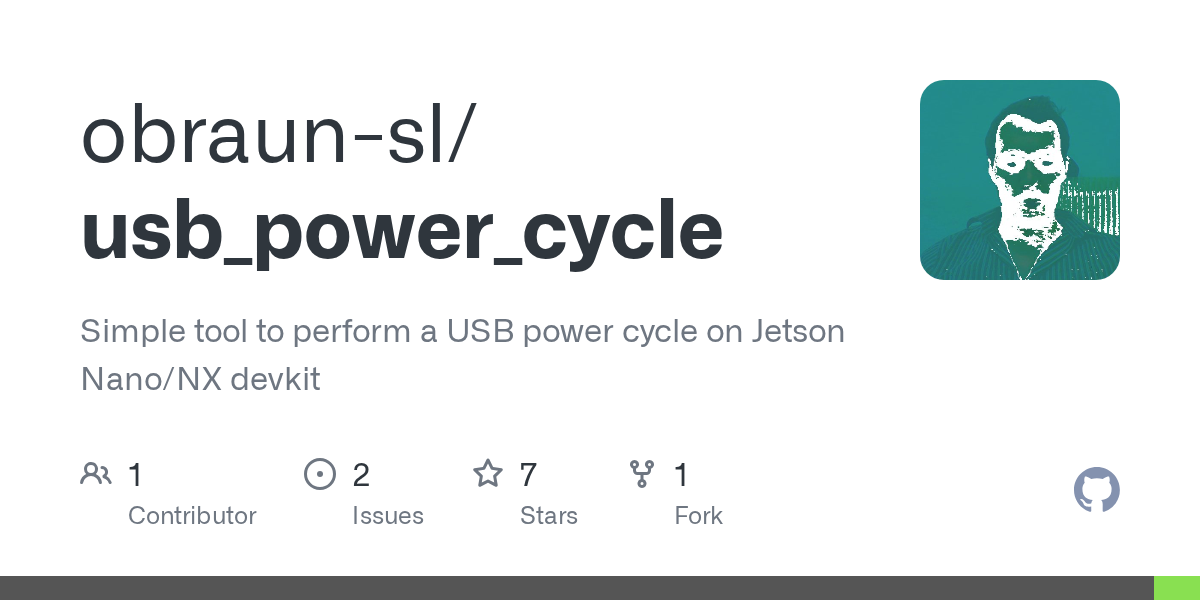

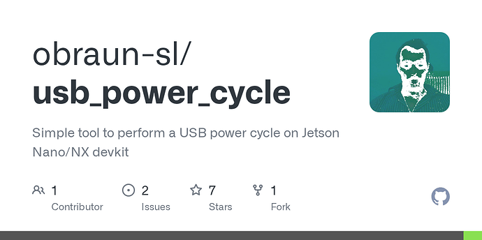

This is a known limitation of the ZED Mini device.
A cold boot does not remove the power to the USB3 port, so the ZED Mini video module is not reset and the USB controller cannot enumerate it again.
Yes, the ZED Mini is an old device. Workaround exists in recent devices to cope with this problem.
You could solve the problem by finding a way to remove the power of the USB port by software.
Normally, this script does the job on older Jetson, I do not know if it could work with Thor too:
