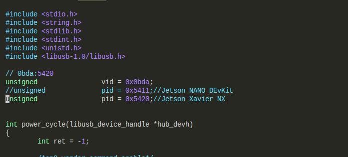

Please note that you must change the PID of the Realtek controller when using the AGX Orin Carrier Board.
You can see here that the PID is 5420, so you must set it here:
I tried the exact thing. changed to unsigned pid = 0x5420;
and ran the following to compile and run
sh build.sh
sudo ./power_cycle
