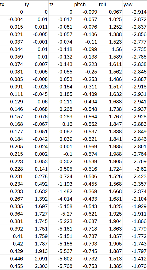

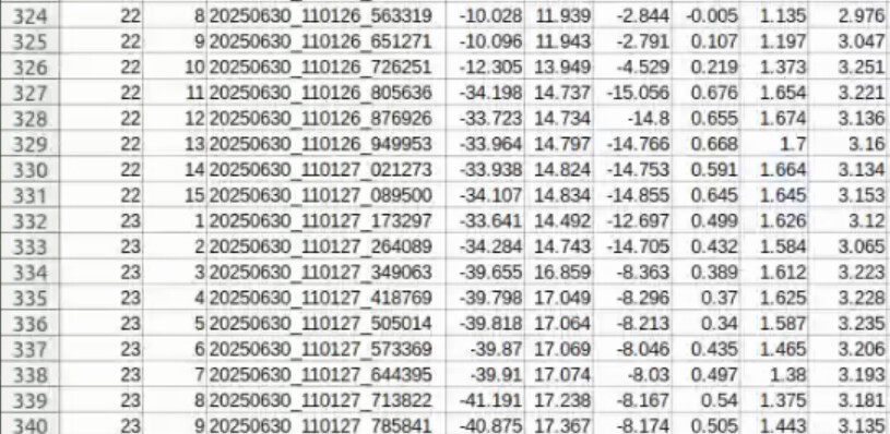

The ZED Mini camera is really accurate when it comes to retrieving the positional data but recently an issue has popped up. Whenever I try to retrieve the positional and save it to an excel file I have been observing anomalous data in between the sets where it spikes significantly by 7-9 cm in either the x coordinate system or the z coordinate system. I have attached a picture below for reference. Please advise on what I should do and if you want to see my code I will direct message you.

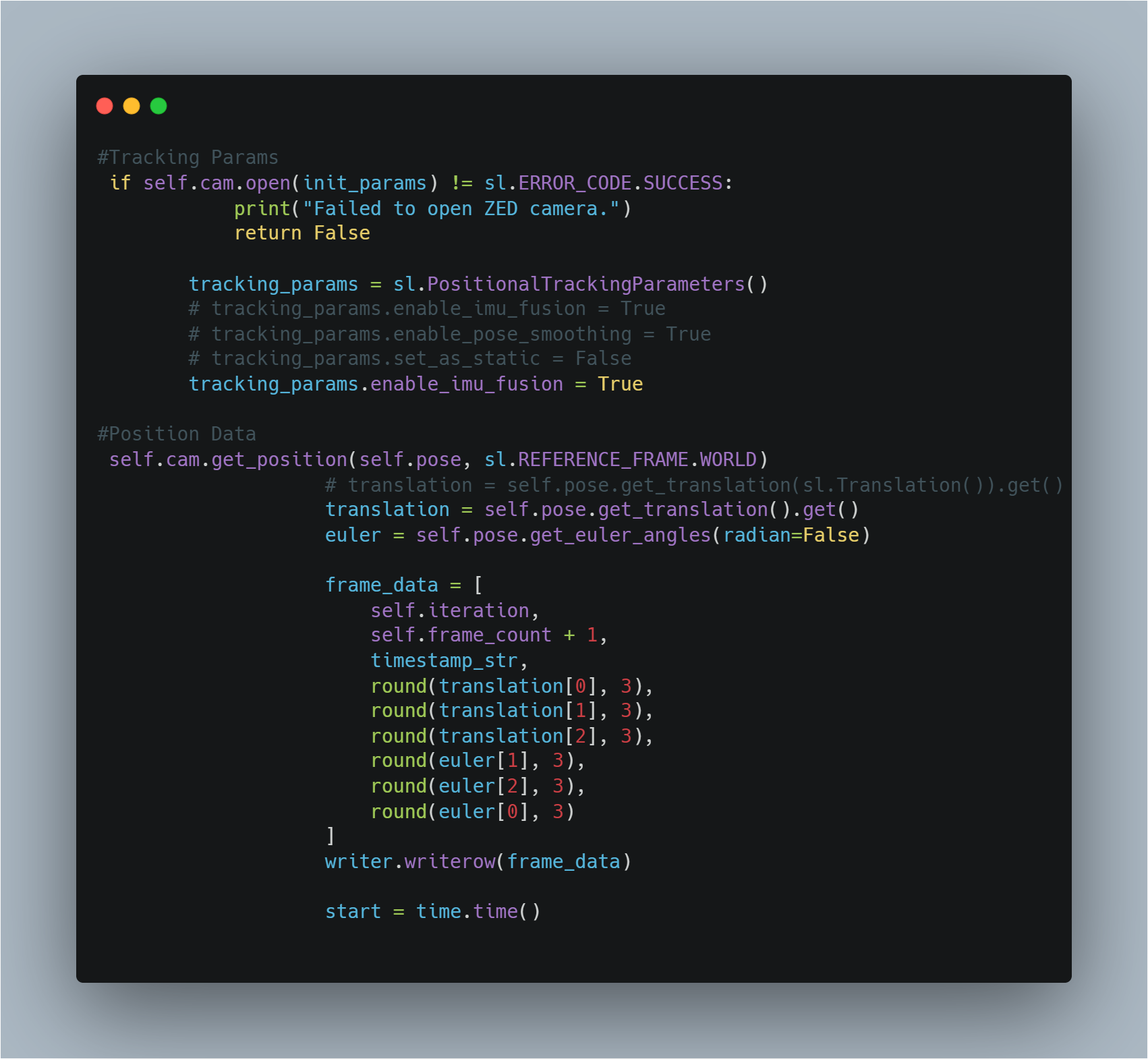

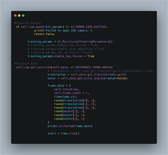

#Tracking Params
if self.cam.open(init_params) != sl.ERROR_CODE.SUCCESS: print("Failed to open ZED camera.")
return False
tracking_params = sl.PositionalTrackingParameters() #tracking_params.enable_imu_fusion = True #tracking_params.enable_pose_smoothing = True #tracking_params.set_as_static = False tracking_params.enable_imu_fusion
#Position Data
= True
self.cam.get_position(self.pose, sl.REFERENCE_FRAME.WORLD)
# translation
translation = self.pose.get_translation().get()
euler = self.pose.get_euler_angles (radian=False)
frame_data = [
self.iteration,
self.frame_count + 1,
timestamp_str,
round(translation[0], 3),
round(translation[1], 3),
round(translation[2], 3),
round(euler [1], 3),
round(euler[2], 3),
round(euler[0], 3)
writer.writerow(frame_data)

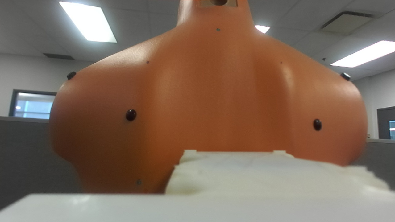

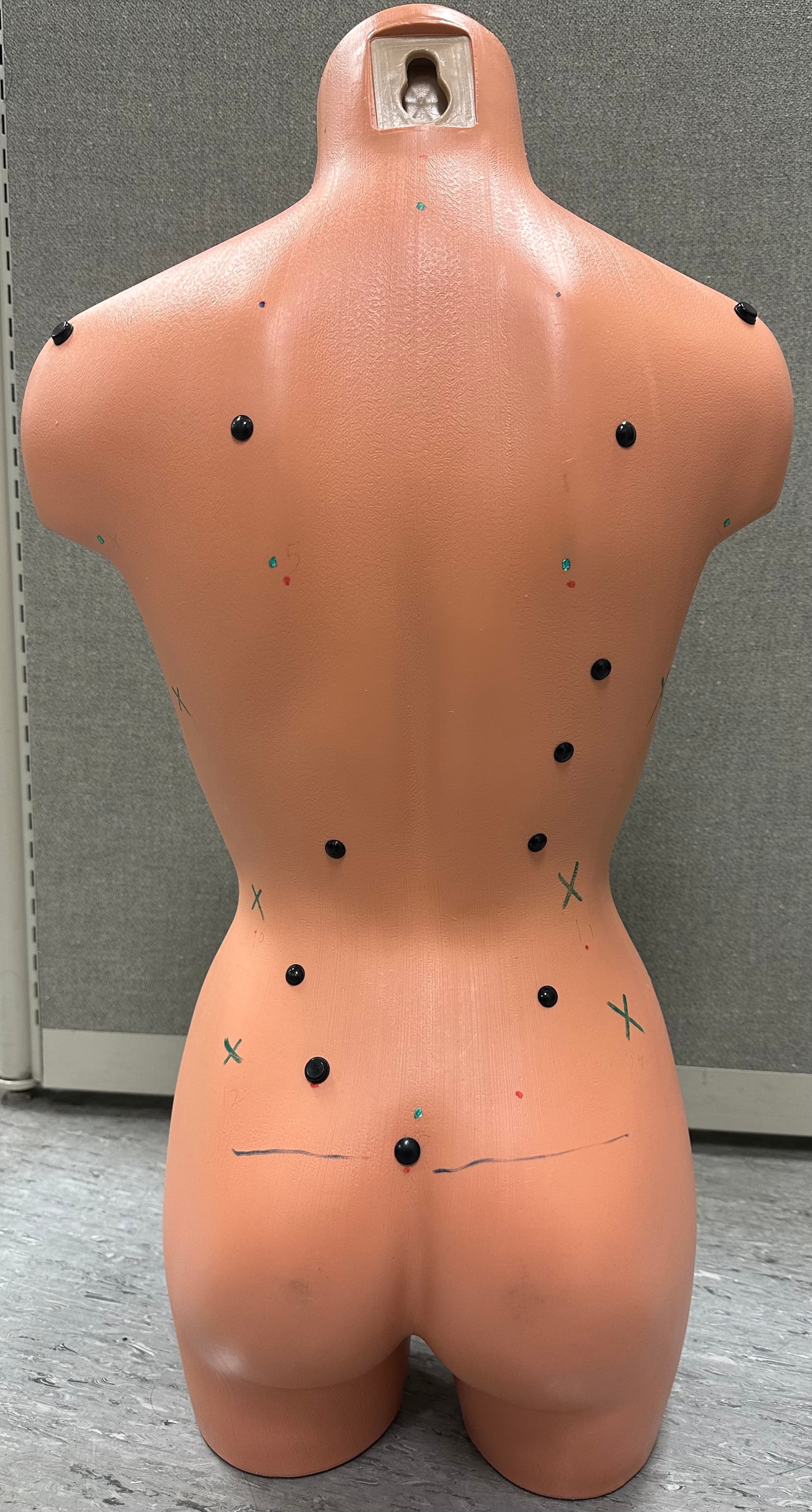

I tried doing that but no change… I am doing a scan of this model:
And using the jetson nano, I am placing it 23 cm away from the model and the picture is shown as below:
Would this texture affect the position as well, I put markers at set points to also improve the tracking.
A video could better explain your process.
23 cm can be really too close to the object; the minimum depth range of the ZED Mini is 10 cm, but when performing positional tracking at close distances, you can lose visual features to be tracked, so increasing the localization error.
50 cm could be a good starting distance for this type of application.
