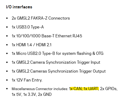

Can you explain more about this HW upgrade? because looks like for now i am stuck with 10 units where the specs say have both CAN and UART, then the manual says there is no CAN transiver and now the forum says no UART. For the intended drone usage, there are not a lot of ways to communicate with the autopilot.
what am I expected to do?
I think you guys need to update the store page for this device these are just wrong
