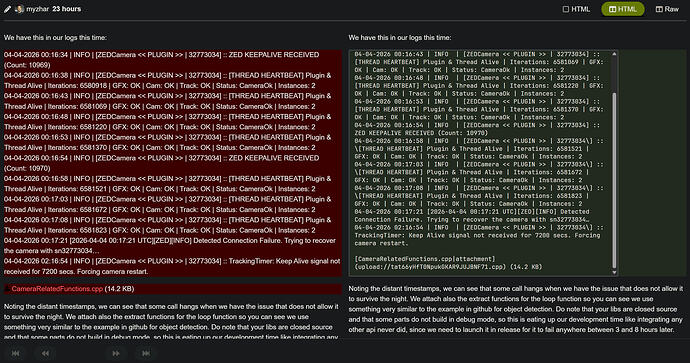

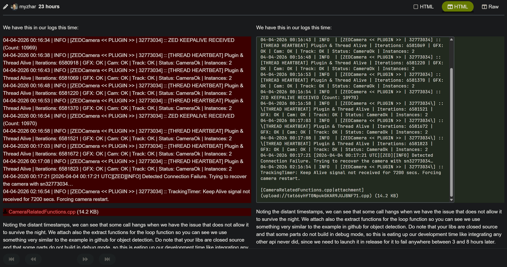

We have this in our logs this time:
04-04-2026 00:16:34 | INFO  | [ZEDCamera << PLUGIN >> | 32773034] :: ZED KEEPALIVE RECEIVED (Count: 10969)
04-04-2026 00:16:38 | INFO  | [ZEDCamera << PLUGIN >> | 32773034] :: [THREAD HEARTBEAT] Plugin & Thread Alive | Iterations: 6580918 | GFX: OK | Cam: OK | Track: OK | Status: CameraOk | Instances: 2
04-04-2026 00:16:43 | INFO  | [ZEDCamera << PLUGIN >> | 32773034] :: [THREAD HEARTBEAT] Plugin & Thread Alive | Iterations: 6581069 | GFX: OK | Cam: OK | Track: OK | Status: CameraOk | Instances: 2
04-04-2026 00:16:48 | INFO  | [ZEDCamera << PLUGIN >> | 32773034] :: [THREAD HEARTBEAT] Plugin & Thread Alive | Iterations: 6581220 | GFX: OK | Cam: OK | Track: OK | Status: CameraOk | Instances: 2
04-04-2026 00:16:53 | INFO  | [ZEDCamera << PLUGIN >> | 32773034] :: [THREAD HEARTBEAT] Plugin & Thread Alive | Iterations: 6581370 | GFX: OK | Cam: OK | Track: OK | Status: CameraOk | Instances: 2
04-04-2026 00:16:54 | INFO  | [ZEDCamera << PLUGIN >> | 32773034] :: ZED KEEPALIVE RECEIVED (Count: 10970)
04-04-2026 00:16:58 | INFO  | [ZEDCamera << PLUGIN >> | 32773034\] :: \[THREAD HEARTBEAT] Plugin & Thread Alive | Iterations: 6581521 | GFX: OK | Cam: OK | Track: OK | Status: CameraOk | Instances: 2
04-04-2026 00:17:03 | INFO  | [ZEDCamera << PLUGIN >> | 32773034\] :: \[THREAD HEARTBEAT] Plugin & Thread Alive | Iterations: 6581672 | GFX: OK | Cam: OK | Track: OK | Status: CameraOk | Instances: 2
04-04-2026 00:17:08 | INFO  | [ZEDCamera << PLUGIN >> | 32773034\] :: \[THREAD HEARTBEAT] Plugin & Thread Alive | Iterations: 6581823 | GFX: OK | Cam: OK | Track: OK | Status: CameraOk | Instances: 2
04-04-2026 00:17:21 [2026-04-04 00:17:21 UTC][ZED][INFO] Detected Connection Failure. Trying to recover the camera with sn32773034…
04-04-2026 02:16:54 | INFO  | [ZEDCamera << PLUGIN >> | 32773034\] :: TrackingTimer: Keep Alive signal not received for 7200 secs. Forcing camera restart.
[CameraRelatedFunctions.cpp|attachment](upload://tat66yHfT0NpukGKAR9JUJBNF71.cpp) (14.2 KB)
Noting the distant timestamps, we can see that some call hangs when we have the issue that does not allow it to survive the night. We attach also the extract functions for the loop function so you can see we use something very similar to the example in github for object detection. Do note that your libs are closed source and that some parts do not build in debug mode, so this is eating up our development time like integrating any other api never did, since we need to launch it in release for it to fail anywhere between 3 and 8 hours later.

Turns out it is grabFrame() as per our logs:
  | INFO  | [ZEDCamera << PLUGIN >> | 31300192] :: C1: T [Before Grab Frame Call]
  | INFO  | [ZEDCamera << PLUGIN >> | 31300192] :: C2: F [After Grab Frame Call]
  | INFO  | [ZEDCamera << PLUGIN >> | 31300192] :: C3: F [After error checking]
  | INFO  | [ZEDCamera << PLUGIN >> | 31300192] :: C4: F [Before Gen Box Tracking]
  | INFO  | [ZEDCamera << PLUGIN >> | 31300192] :: C5: F [After Gen Box Tracking]
  | INFO  | [ZEDCamera << PLUGIN >> | 31300192] :: C6: F [After error checking]

And we have SDK logs too. The one that the SDK puts out when we lose them is :
11-04-2026 05:37:10 6-04-11 05:37:10 UTC][ZED][INFO] Detected Connection Failure. Trying to recover the camera with sn32773034...
And for another camera:
11-04-2026 02:51:33 6-04-11 02:51:33 UTC][ZED][INFO] Detected Connection Failure. Trying to recover the camera with sn31300192...
So now we can confirm that in our setup we are having our thread blocked by the Zed SDK, with which we share an OpenGL context with, and thus losing tracking info until application reboot with no ability to recover from this issue, since the locked thread keeps the Zed busy.
