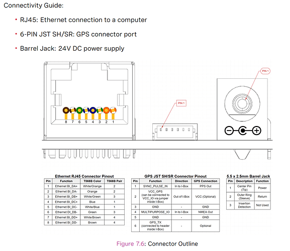

Below are the references provided by ZED that I consulted, and the image below is the connector photo related to hard sync on the Ouster LiDAR.

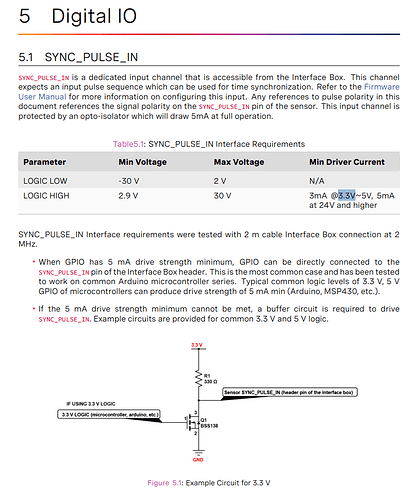

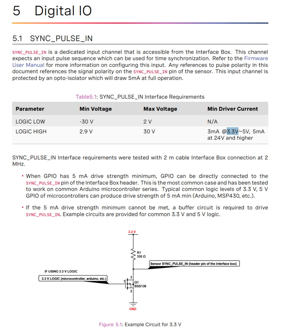

Please note that if the SINC_PULSE_IN of the Ouster requires a different voltage than the provided 3.3V, you need a voltage converter circuit too.

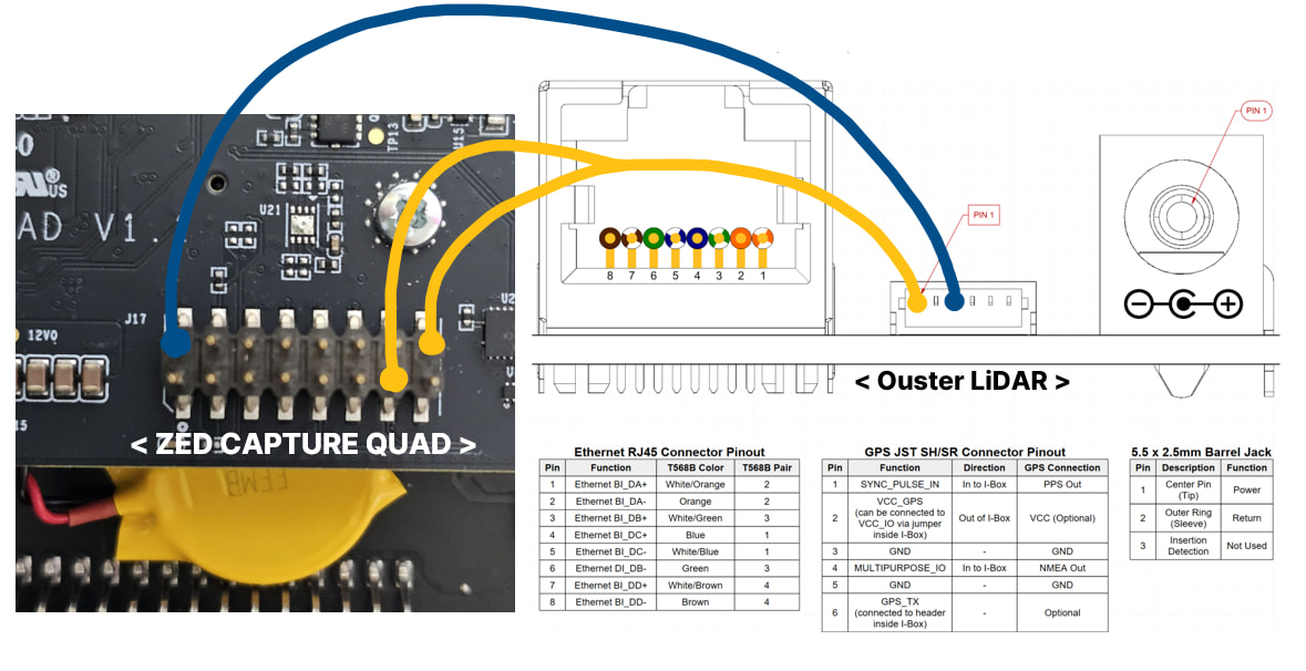

If I understand correctly, should I proceed with the wiring work like this?
I’m sharing a document I found regarding sync_pulse_in on the Ouster LiDAR hardware.
In my perspective, everything looks fine, but do you see any potential issues related to the voltage you mentioned? I’m not very familiar with this area, so even though I checked it myself, I wanted to ask again to confirm from an expert’s perspective.
