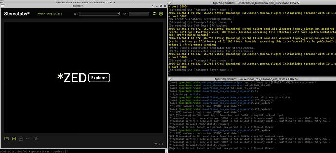

I reinstalled isaamSIM 5 by building from source, and I made a bit of progress but now the camera closes immediately after opening and says the port is busy (See video). I have not been able to keep it open in ZED_Depth_Viewer or ZED_Explorer. I have tried different ports but I get the same error regardless. How can I get it to stay open? Terminal output is also shown from when I run ZED_Explorer
ZED Isaac Sim video
** [SV0] Hardware compression (NVENC) available **
[ZED][Streaming] Switching to SHM-boost backend input
[Streaming] Warning : receiving port 30002 is not available (already used)... switching to port 30004. Retrying...
[Streaming] Backward compatibility required.
QObject::setParent: Cannot set parent, new parent is in a different thread.
In the IsaacSIM window, I see the following output:
[Port: 30002] Constructed annotator for stereo camera.
2026-03-23T15:15:44Z [3,984,218ms] [Warning] [sl.sensor.camera.plugin] Initializing streamer with ID 0 on port 30002
YUV encoding enabled, overriding RGB/BGR.
[Streaming] Use Transport layer mode : 2
[Streaming] Use SHM-Boost IPC backend
This is the output when I try ZED_Depth_Viewer:
[2026-03-23 11:17:39 UTC][ZED][INFO] Logging level INFO
[2026-03-23 11:17:39 UTC][ZED][INFO] [Init]  Serial Number: S/N 45626933
[2026-03-23 11:17:39 UTC][ZED][WARNING] Simulated ZED camera used ZED X
[2026-03-23 11:17:39 UTC][ZED][WARNING] [Init]  Invalid calibration file format. On Linux, run export LC_ALL="C" and restart your application.
[2026-03-23 11:17:39 UTC][ZED][WARNING] Self Calibration Disabled.
[2026-03-23 11:17:39 UTC][ZED][INFO] [Init]  Depth mode selected: NEURAL. Ensure this mode matches your application's performance and accuracy requirements. See https://www.stereolabs.com/docs/depth-sensing/depth-modes for help

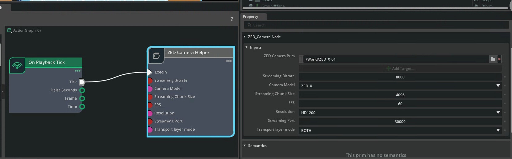

Can you try not using IPC ? It can be changed in the Action graph by setting the “transport layer mode” to 'NETWORK". It would help me understand where the issue comes from.
Thanks!

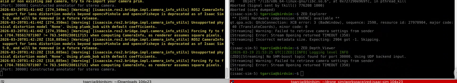

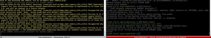

It still does not work when I have it turned off. (I have two cameras in this setup, one on port 30000 and one on 30002.) It seems like it attempts to use both of them but then says they are busy. See screenshot.
