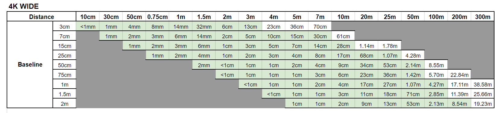

Hi @NivC
You can find a reply to all questions by reading this support page and using the information in the tables:
https://support.stereolabs.com/hc/en-us/articles/20851232732311-Setting-up-your-Stereo-Rig-with-two-ZED-X-One-cameras

This is the theoretical maximum value, and it’s correct.
We provide accuracy info up to 300m:
