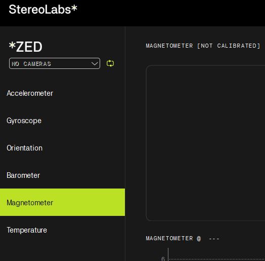

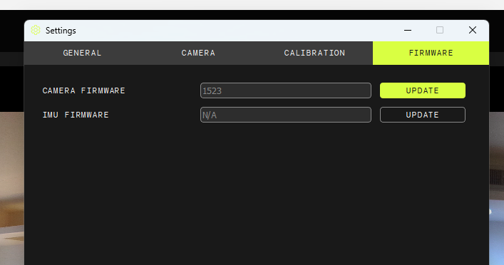

Latest (at the moment SDK version 5.0.5), Camera firmware: 1523, I updated and optimized everything, but when I try to run ZED Sensor Viewer it stucks (show windows-i-dont-know-whats-happening-spining-wheel cursor or shows no data from any sensor :

Your camera model (ZED1, not ZED2) does not have an IMU, which explains why nothing is available in ZED Sensor Viewer.
